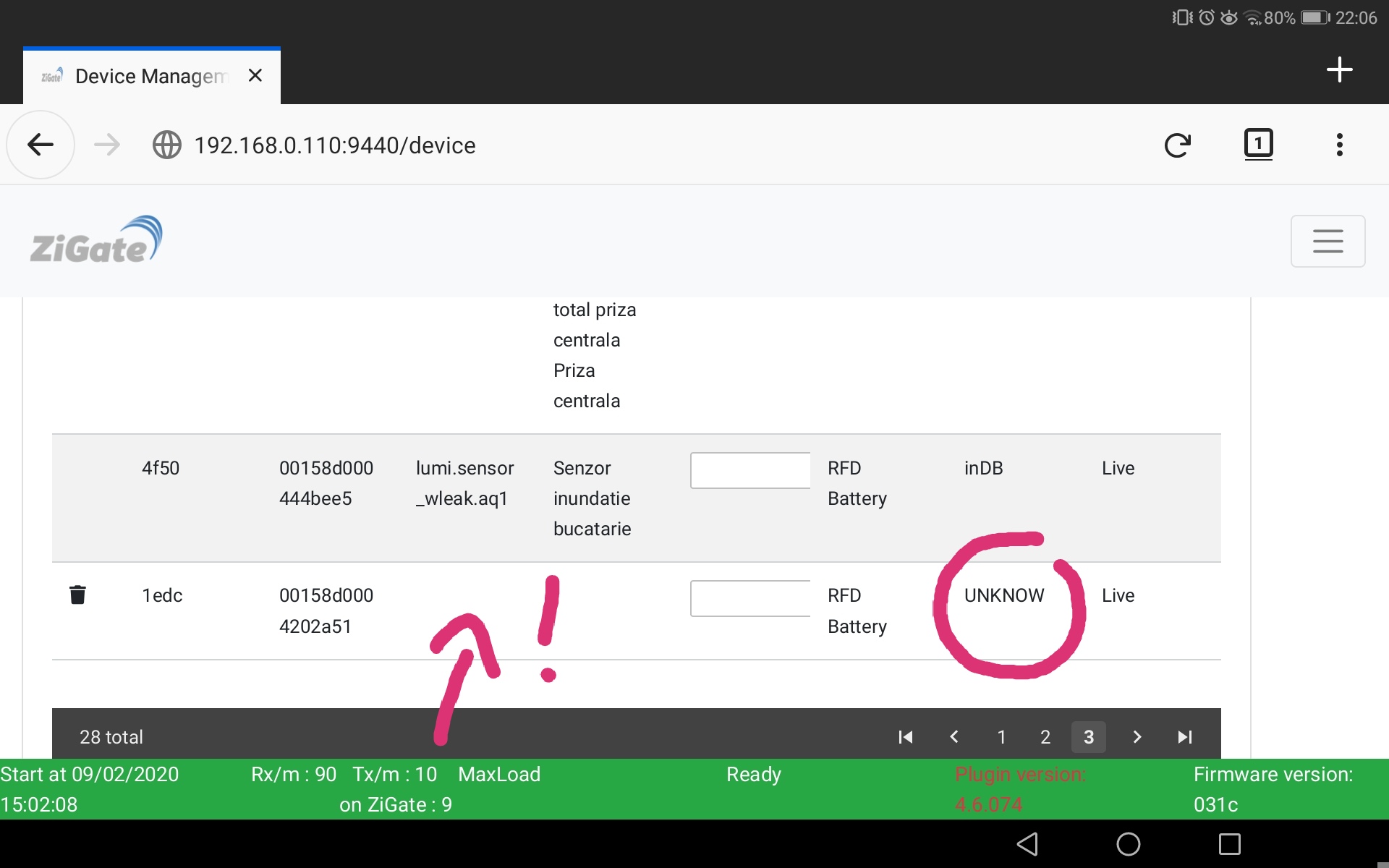

No success, but I have a suggestion and I don't know if you can to add for the new version of zigate web interface the possibility to select manually type of the sensor with malfunction. I said that because the sensor it is displayed in the Web interface with short Id, ieee but with type sensor(model) field empty and without name but with the status is live. I think that solution could solve this pairing problems for xiaomi or other sensors. Please look at my attachment.

It is reported like that in the Web Admin, with the 'Trash' icon so you can remove it, otherwise at the next plugin restart it will automatically be removed.
It is key that we get the Model Name and/or a full discovery of the device, if this is not happen, the plugin do consider that there are some issue and don't move forward.

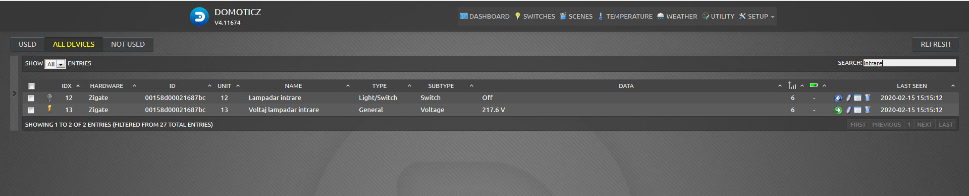

I solved with fresh raspbian install and erase eeprom end reflash the zigate. Pairing works now but i saw that after i paired xiaomi plug...missing the power measurement(live Usage Electric in Watt) from devices list for the all xiaomi plugs. There is only plug_Voltage and switch.
