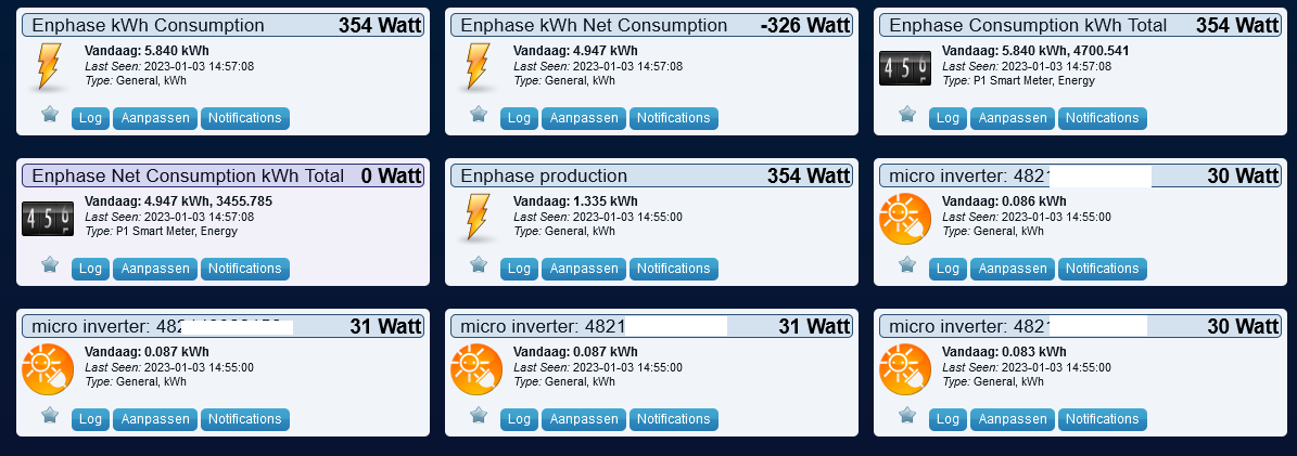

If you have createDevices = true then Domoticz will create the micro inverter devices for you. At least if you allow creation of new devices in settings page.

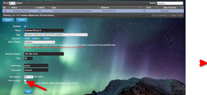

I made a backup then installed the latest build 14905
On the other hand, I don't have anything to put my token or my passwords when I want to add the Enphase hardware?
I do not understand why.........
thanks again
Rpi Master 2022.2 Beta 14905 (Broadlink ok.....)
Rpi slave 2020.2 (since 10days but with error...) with 2 rflink(rts 433 + 833)
FireWizard
Posts: 1968
Location: Voorthuizen (NL)
Re: Get local Enphase data from individual solar panels in domoticz
Post by FireWizard »
Did you clear your cache?
