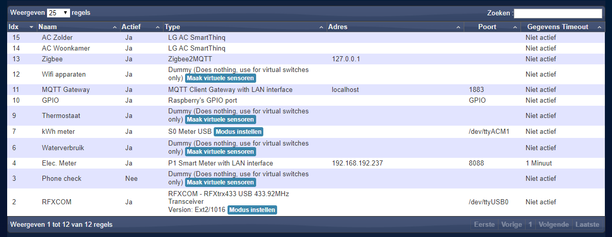

If got this settings and bulb:
I will backup my SD-card of my Raspberry Pi, after that I will try to update MQTT WITH DISCOVERY
I'll find out how to install this on my PI (Stretch-version)
RFXcom433e ver1009,Raspberry Pi,Domoticz v3.5877
KaKu:16c remote,dimmer,wall-sockets,sunscreenswitch
Promax:wall sockets Elro:wall sockets Somfy:RFY screens
TFA:weather station Chinese temperature sensors, smoke detectors, power switches

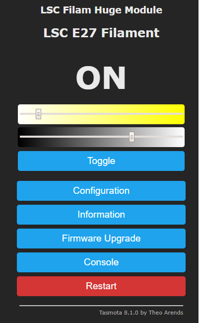

And on the webpage of my device in Tasmota, it shows this:
Melissen
Posts: 65
Joined: Wednesday 16 November 2016 9:39
Re: Action LSC Smart Connect lights and sensors?
Post by Melissen »
PROBLEMS SOLVED !!!
Installed MQTT Discovery and set SetOption 19 1 in all devices, accepted new devices...... and all devices came in automatically...
Smart Filament Lamp is now the way it should be
Many thanks to all
