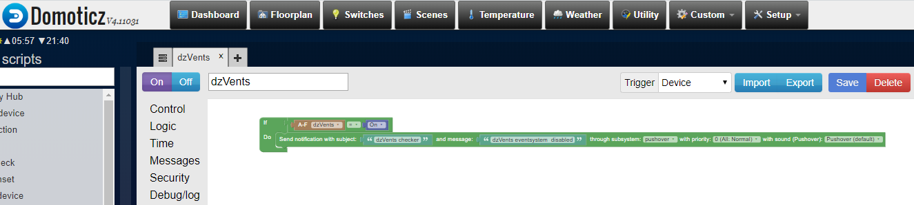

dzVents check alive Blockly
copy code below to your clipboard and import into a device triggered Blockly script. The Blockly is set to send an alert using the pushover subsystem but you can easily change that to one of the other notification subsystems.
<xml xmlns="http://www.w3.org/1999/xhtml"><block type="domoticzcontrols_if" id="6]gTA!5}Pl*[|6#E3j~_" x="16" y="10"><value name="IF0"><block type="logic_compare" id="z#qwCs!QS_oQjYvfb;zN"><field name="OP">EQ</field><value name="A"><block type="switchvariablesAF" id="{i-I2P_61r@i;bT^]0!?"><field name="Switch">2233</field></block></value><value name="B"><block type="logic_states" id="J@+zJxa7/0WbbtbP*WC-"><field name="State">On</field></block></value></block></value><statement name="DO0"><block type="send_notification" id="0kuGPumno2:5XBs2U3?Z"><field name="notificationSubsystem">pushover</field><field name="notificationPriority">0</field><field name="notificationSound">pushover</field><value name="notificationTextSubject"><block type="text" id="`;U[a2LtgRBVQQOS#WTU"><field name="TEXT">dzVents checker</field></block></value><value name="notificationTextBody"><block type="text" id="bW*GzY}qG.gnu}yeY]eG"><field name="TEXT">dzVents eventsystem  disabled</field></block></value></block></statement></block></xml>

Thanks done it and checked it; it works! Now I can wait and see if it happens and examine the log on the right time. Apparently the delayed switch command, once triggered, does not depend anymore on the dzvents systems being active. I only have to remember to switch off the virtual switch manually after turning dzVents back on, otherwise it will stay on.
