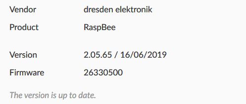

- A configuration problem, on phoscon you have the last deconz version and last firmware version too ? Nothing strange on config page, something like that (this screenshot is not up to date)

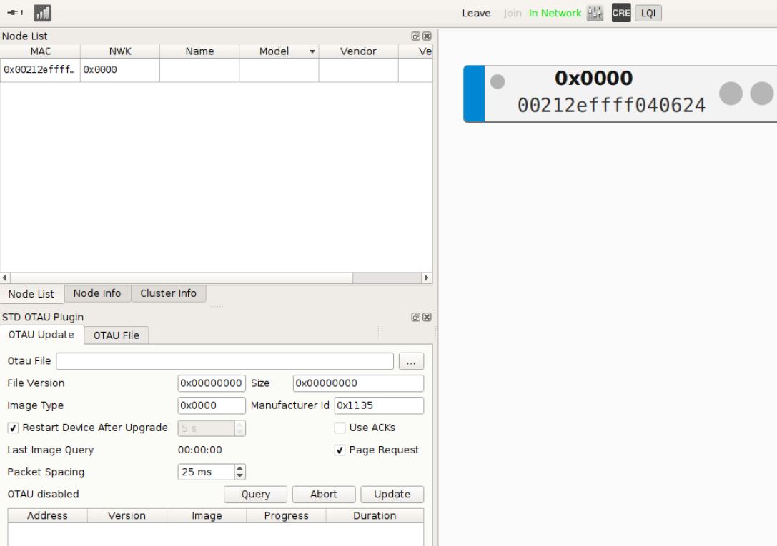

All of what you have mentioned is fine as you can see from the first pic, running deconz on the Pi I just see one node which is the Raspbee, doesn't matter how long i hold the reset for nothing shows up, if i hold it for more than 10 sec after the first 3 flashes when i release it there is no more but if I release after three flashes there are another 2 with the second being slightly longer than the first.

LQI now disabled, yes on cree both are ticked, no other zigbee gateway here anywhere.

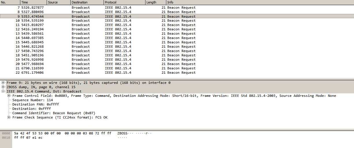

Bit of an update although it doesn't resolve my issue, I have a CC2531 usb dongle so flashed it with ZBOSS sniffer firmware for zigbee devices, installed the software along with wireshark and had a look what was going on, so the result is no matter how you press the button on the door sensor (times or duration) the code sent is the same, it just sends a broacast request (see pic) and if in deconz I use the signal monitor option and tell it to send continous packets I see nothing at all in the sniffing software, however as the only node deconz can see is its self I'm unsure if its actually transmitting depite the green led on the raspbee flashing rapidly so despite this its still back to ikea for a lamp !!

Ha nice, you have a zigbee sniffer, realy usefull !
I m making a github issue, not sure I will have answer, but for me your bug is critic enought to find motived users.
For me your sensor are good, not possible having 4 broken one, but I realy don't have idea to explain what isn't working.
