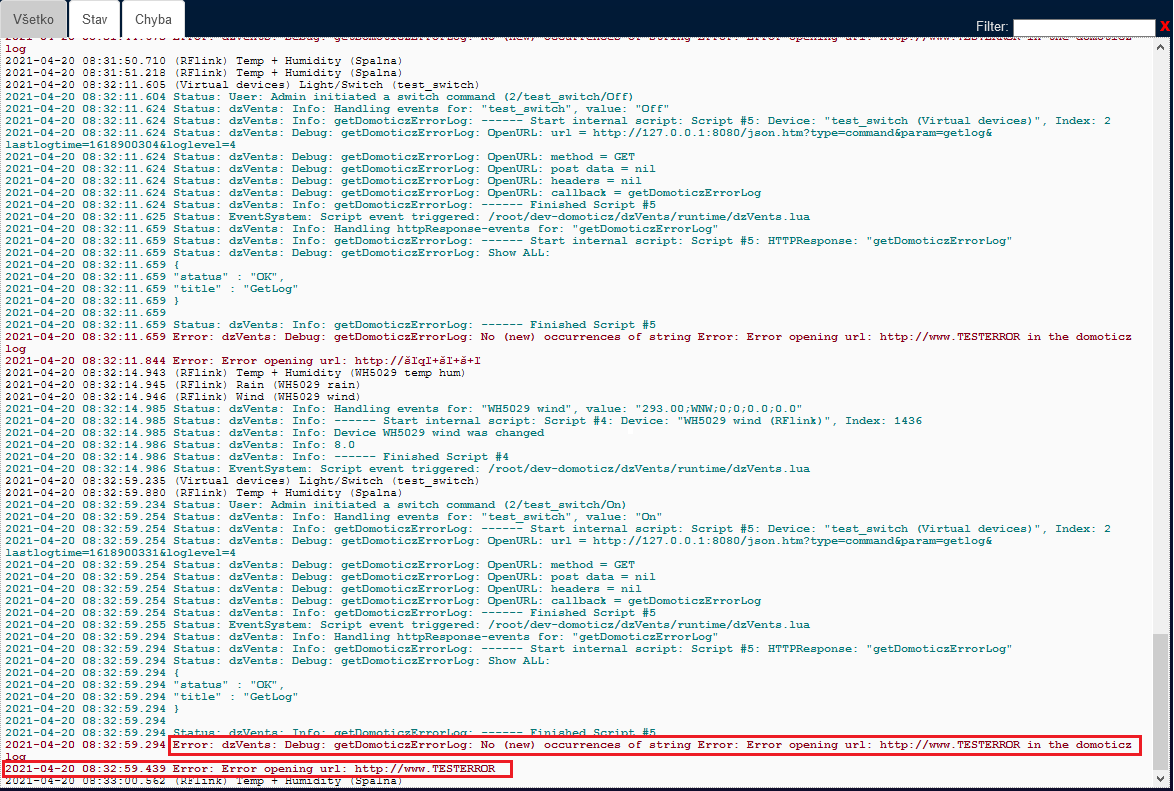

Re: Use an error in log as a trigger
madpatrick wrote: Saturday 23 January 2021 14:54 I've changed the script a little bit to get a message when any error is in the log file, but i see a error line in the log running the script.
Not sure that it means or whether it is an problem
That should not be a problem. Domoticz recognize the word Error and report that in the log as a log message with type Error.
The functionality of the script is not hampered by that behavior.
madpatrick wrote: Saturday 23 January 2021 20:09 Is it possible to filter out the reporting which a specific word is in an error message.
In below version you can filter out 0 or more strings you don't want to be reported on.

This is not test message. Its a button with not existing URL on action - thats what i want to monitor, if i turn on heating and device (esp8266) is not respondig, revert status of my switch back by call url directly to device in domoticz.. Maybe this is not the correct way, because now is searching for all erros in log.
 2021-04-20 13:31:01.259 Status: User: Admin initiated a switch command (2/test_switch/On)
2021-04-20 13:31:01.286 Status: dzVents: Info: Handling events for: "test_switch", value: "On"
2021-04-20 13:31:01.286 Status: dzVents: Info: getDomoticzErrorLog: ------ Start internal script: Script #5: Device: "test_switch (Virtual devices)", Index: 2
2021-04-20 13:31:01.286 Status: dzVents: Debug: getDomoticzErrorLog: OpenURL: url = http://127.0.0.1:8080/json.htm?type=command&param=getlog&lastlogtime=1618918167&loglevel=4
2021-04-20 13:31:01.286 Status: dzVents: Debug: getDomoticzErrorLog: OpenURL: method = GET
2021-04-20 13:31:01.286 Status: dzVents: Debug: getDomoticzErrorLog: OpenURL: post data = nil
2021-04-20 13:31:01.286 Status: dzVents: Debug: getDomoticzErrorLog: OpenURL: headers = nil
2021-04-20 13:31:01.286 Status: dzVents: Debug: getDomoticzErrorLog: OpenURL: callback = getDomoticzErrorLog
2021-04-20 13:31:01.287 Status: dzVents: Info: getDomoticzErrorLog: ------ Finished Script #5
2021-04-20 13:31:01.287 Status: EventSystem: Script event triggered: /root/dev-domoticz/dzVents/runtime/dzVents.lua
2021-04-20 13:31:01.346 Status: dzVents: Info: Handling httpResponse-events for: "getDomoticzErrorLog"
2021-04-20 13:31:01.346 Status: dzVents: Info: getDomoticzErrorLog: ------ Start internal script: Script #5: HTTPResponse: "getDomoticzErrorLog"
2021-04-20 13:31:01.347 Status: dzVents: Debug: getDomoticzErrorLog: No resulting loglines found for the set logLevel / searchstrings in the last 94 seconds.
2021-04-20 13:31:01.347 Status: dzVents: Debug: getDomoticzErrorLog: No (new) occurrences of string Error opening url in the domoticz log
2021-04-20 13:31:01.347 Status: dzVents: Debug: getDomoticzErrorLog: OpenURL: url = http://www.TESTERROR
2021-04-20 13:31:01.347 Status: dzVents: Debug: getDomoticzErrorLog: OpenURL: method = GET
2021-04-20 13:31:01.347 Status: dzVents: Debug: getDomoticzErrorLog: OpenURL: post data = nil
2021-04-20 13:31:01.347 Status: dzVents: Debug: getDomoticzErrorLog: OpenURL: headers = nil
2021-04-20 13:31:01.347 Status: dzVents: Debug: getDomoticzErrorLog: OpenURL: callback = nil
2021-04-20 13:31:01.347 Status: dzVents: Info: getDomoticzErrorLog: ------ Finished Script #5
2021-04-20 13:31:01.347 Status: EventSystem: Script event triggered: /root/dev-domoticz/dzVents/runtime/dzVents.lua
2021-04-20 13:31:01.347 Error: dzVents: Debug: getDomoticzErrorLog: Show ALL:
2021-04-20 13:31:01.347 {
2021-04-20 13:31:01.347 "LastLogTime" : "1618918168",
2021-04-20 13:31:01.347 "result" :
2021-04-20 13:31:01.347 [
2021-04-20 13:31:01.347 "level" : 4,
2021-04-20 13:31:01.347 "message" : "2021-04-20 13:29:28.565 Error: dzVents: Debug: getDomoticzErrorLog: Show ALL: \n{\n\t\"LastLogTime\" : \"1618918157\",\n\t\"result\" : \n\t[\n\t\t{\n\t\t\t\"level\" : 4,\n\t\t\t\"message\" : \"2021-04-20 13:29:17.334 Error: dzVents: Debug: getDomoticzErrorLog: Show ALL: \\n{\\n\\t\\\"LastLogTime\\\" : \\\"1618917940\\\",\\n\\t\\\"result\\\" : \\n\\t[\\n\\t\\t{\\n\\t\\t\\t\\\"level\\\" : 4,\\n\\t\\t\\t\\\"message\\\" : \\\"2021-04-20 13:25:13.881 Error: dzVents: Debug: getDomoticzErrorLog: Log Error: Error opening url: http://www.TESTERROR found! \\\"\\n\\t\\t},\\n\\t\\t{\\n\\t\\t\\t\\\"level\\\" : 4,\\n\\t\\t\\t\\\"message\\\" : \\\"2021-04-20 13:25:14.063 Error: Error opening url: http://test_off_error\\\"\\n\\t\\t},\\n\\t\\t{\\n\\t\\t\\t\\\"level\\\" : 4,\\n\\t\\t\\t\\\"message\\\" : \\\"2021-04-20 13:25:35.675 Error: Error opening url: http://www.TESTERROR\\\"\\n\\t\\t},\\n\\t\\t{\\n\\t\\t\\t\\\"level\\\" : 4,\\n\\t\\t\\t\\\"message\\\" : \\\"2021-04-20 13:25:40.648 Error: Error opening url: http://test_off_error\\\"\\n\\t\\t}\\n\\t],\\n\\t\\\"status\\\" : \\\"OK\\\",\\n\\t\\\"title\\\" : \\\"GetLog\\\"\\n}\\n\"\n\t\t},\n\t\t{\n\t\t\t\"level\" : 4,\n\t\t\t\"message\" : \"2021-04-20 13:29:17.356 Error: Error opening url: http://www.TESTERROR\"\n\t\t},\n\t\t{\n\t\t\t\"level\" : 4,\n\t\t\t\"message\" : \"2021-04-20 13:29:17.477 Error: Error opening url: http://www.TESTERROR\"\n\t\t}\n\t],\n\t\"status\" : \"OK\",\n\t\"title\" : \"GetLog\"\n}\n"
2021-04-20 13:31:01.347 },
2021-04-20 13:31:01.347 "message" : "2021-04-20 13:29:28.586 Error: Error opening url: http://www.TESTERROR"
2021-04-20 13:31:01.347 "message" : "2021-04-20 13:29:28.707 Error: Error opening url: http://test_off_error"
2021-04-20 13:31:01.347 ],
2021-04-20 13:31:01.347 "status" : "OK",
2021-04-20 13:31:01.347 "title" : "GetLog"
2021-04-20 13:31:01.368 Error: Error opening url: http://www.TESTERROR
2021-04-20 13:31:01.489 Error: Error opening url: http://www.TESTERROR

2021-04-20 13:31:58.725 Status: dzVents: Info: getDomoticzErrorLog: ------ Start internal script: Script #5: HTTPResponse: "getDomoticzErrorLog"
2021-04-20 13:31:58.727 Status: dzVents: Debug: getDomoticzErrorLog: No resulting loglines found for the set logLevel / searchstrings in the last 58 seconds.
2021-04-20 13:31:58.727 Status: dzVents: Debug: getDomoticzErrorLog: No (new) occurrences of string Error opening url in the domoticz log
2021-04-20 13:31:58.727 Status: dzVents: Debug: getDomoticzErrorLog: OpenURL: url = http://www.TESTERROR
2021-04-20 13:31:58.727 Status: dzVents: Debug: getDomoticzErrorLog: OpenURL: method = GET
2021-04-20 13:31:58.727 Status: dzVents: Debug: getDomoticzErrorLog: OpenURL: post data = nil
2021-04-20 13:31:58.727 Status: dzVents: Debug: getDomoticzErrorLog: OpenURL: headers = nil
2021-04-20 13:31:58.727 Status: dzVents: Debug: getDomoticzErrorLog: OpenURL: callback = nil
2021-04-20 13:31:58.727 Status: dzVents: Info: getDomoticzErrorLog: ------ Finished Script #5
2021-04-20 13:31:58.727 Status: EventSystem: Script event triggered: /root/dev-domoticz/dzVents/runtime/dzVents.lua
2021-04-20 13:31:58.727 Error: dzVents: Debug: getDomoticzErrorLog: Show ALL:
2021-04-20 13:31:58.727 {
2021-04-20 13:31:58.727 "LastLogTime" : "1618918261",
2021-04-20 13:31:58.727 "result" :
2021-04-20 13:31:58.727 [
2021-04-20 13:31:58.727 "level" : 4,
2021-04-20 13:31:58.727 "message" : "2021-04-20 13:31:01.347 Error: dzVents: Debug: getDomoticzErrorLog: Show ALL: \n{\n\t\"LastLogTime\" : \"1618918168\",\n\t\"result\" : \n\t[\n\t\t{\n\t\t\t\"level\" : 4,\n\t\t\t\"message\" : \"2021-04-20 13:29:28.565 Error: dzVents: Debug: getDomoticzErrorLog: Show ALL: \\n{\\n\\t\\\"LastLogTime\\\" : \\\"1618918157\\\",\\n\\t\\\"result\\\" : \\n\\t[\\n\\t\\t{\\n\\t\\t\\t\\\"level\\\" : 4,\\n\\t\\t\\t\\\"message\\\" : \\\"2021-04-20 13:29:17.334 Error: dzVents: Debug: getDomoticzErrorLog: Show ALL: \\\\n{\\\\n\\\\t\\\\\\\"LastLogTime\\\\\\\" : \\\\\\\"1618917940\\\\\\\",\\\\n\\\\t\\\\\\\"result\\\\\\\" : \\\\n\\\\t[\\\\n\\\\t\\\\t{\\\\n\\\\t\\\\t\\\\t\\\\\\\"level\\\\\\\" : 4,\\\\n\\\\t\\\\t\\\\t\\\\\\\"message\\\\\\\" : \\\\\\\"2021-04-20 13:25:13.881 Error: dzVents: Debug: getDomoticzErrorLog: Log Error: Error opening url: http://www.TESTERROR found! \\\\\\\"\\\\n\\\\t\\\\t},\\\\n\\\\t\\\\t{\\\\n\\\\t\\\\t\\\\t\\\\\\\"level\\\\\\\" : 4,\\\\n\\\\t\\\\t\\\\t\\\\\\\"message\\\\\\\" : \\\\\\\"2021-04-20 13:25:14.063 Error: Error opening url: http://test_off_error\\\\\\\"\\\\n\\\\t\\\\t},\\\\n\\\\t\\\\t{\\\\n\\\\t\\\\t\\\\t\\\\\\\"level\\\\\\\" : 4,\\\\n\\\\t\\\\t\\\\t\\\\\\\"message\\\\\\\" : \\\\\\\"2021-04-20 13:25:35.675 Error: Error opening url: http://www.TESTERROR\\\\\\\"\\\\n\\\\t\\\\t},\\\\n\\\\t\\\\t{\\\\n\\\\t\\\\t\\\\t\\\\\\\"level\\\\\\\" : 4,\\\\n\\\\t\\\\t\\\\t\\\\\\\"message\\\\\\\" : \\\\\\\"2021-04-20 13:25:40.648 Error: Error opening url: http://test_off_error\\\\\\\"\\\\n\\\\t\\\\t}\\\\n\\\\t],\\\\n\\\\t\\\\\\\"status\\\\\\\" : \\\\\\\"OK\\\\\\\",\\\\n\\\\t\\\\\\\"title\\\\\\\" : \\\\\\\"GetLog\\\\\\\"\\\\n}\\\\n\\\"\\n\\t\\t},\\n\\t\\t{\\n\\t\\t\\t\\\"level\\\" : 4,\\n\\t\\t\\t\\\"message\\\" : \\\"2021-04-20 13:29:17.356 Error: Error opening url: http://www.TESTERROR\\\"\\n\\t\\t},\\n\\t\\t{\\n\\t\\t\\t\\\"level\\\" : 4,\\n\\t\\t\\t\\\"message\\\" : \\\"2021-04-20 13:29:17.477 Error: Error opening url: http://www.TESTERROR\\\"\\n\\t\\t}\\n\\t],\\n\\t\\\"status\\\" : \\\"OK\\\",\\n\\t\\\"title\\\" : \\\"GetLog\\\"\\n}\\n\"\n\t\t},\n\t\t{\n\t\t\t\"level\" : 4,\n\t\t\t\"message\" : \"2021-04-20 13:29:28.586 Error: Error opening url: http://www.TESTERROR\"\n\t\t},\n\t\t{\n\t\t\t\"level\" : 4,\n\t\t\t\"message\" : \"2021-04-20 13:29:28.707 Error: Error opening url: http://test_off_error\"\n\t\t}\n\t],\n\t\"status\" : \"OK\",\n\t\"title\" : \"GetLog\"\n}\n"
2021-04-20 13:31:58.727 },
2021-04-20 13:31:58.727 "message" : "2021-04-20 13:31:01.368 Error: Error opening url: http://www.TESTERROR"
2021-04-20 13:31:58.727 "message" : "2021-04-20 13:31:01.489 Error: Error opening url: http://www.TESTERROR"
2021-04-20 13:31:58.727 ],
2021-04-20 13:31:58.727 "status" : "OK",
2021-04-20 13:31:58.727 "title" : "GetLog"
2021-04-20 13:31:58.747 Error: Error opening url: http://www.TESTERROR
2021-04-20 13:31:58.868 Error: Error opening url: http://test_off_error
2021-04-20 13:31:59.849 (RFlink) Temp + Humidity (Spalna)
2021-04-20 13:32:06.848 Status: EventSystem: reset all events...
2021-04-20 13:32:06.848 Status: dzVents: Write file: /root/dev-domoticz/scripts/dzVents/generated_scripts/Script #4.lua
2021-04-20 13:32:06.848 Status: dzVents: Write file: /root/dev-domoticz/scripts/dzVents/generated_scripts/Script #5.lua
2021-04-20 13:32:16.043 Status: EventSystem: reset all events...
2021-04-20 13:32:16.043 Status: dzVents: Write file: /root/dev-domoticz/scripts/dzVents/generated_scripts/Script #4.lua
2021-04-20 13:32:16.043 Status: dzVents: Write file: /root/dev-domoticz/scripts/dzVents/generated_scripts/Script #5.lua
2021-04-20 13:32:21.902 Status: EventSystem: reset all device statuses...
2021-04-20 13:32:36.236 (Virtual devices) Light/Switch (test_switch)
2021-04-20 13:32:36.236 Status: User: Admin initiated a switch command (2/test_switch/On)
2021-04-20 13:32:36.262 Status: dzVents: Info: Handling events for: "test_switch", value: "On"
2021-04-20 13:32:36.262 Status: dzVents: Info: getDomoticzErrorLog: ------ Start internal script: Script #5: Device: "test_switch (Virtual devices)", Index: 2
2021-04-20 13:32:36.262 Status: dzVents: Debug: getDomoticzErrorLog: OpenURL: url = http://127.0.0.1:8080/json.htm?type=command&param=getlog&lastlogtime=1618918317&loglevel=4
2021-04-20 13:32:36.262 Status: dzVents: Debug: getDomoticzErrorLog: OpenURL: method = GET
2021-04-20 13:32:36.262 Status: dzVents: Debug: getDomoticzErrorLog: OpenURL: post data = nil
2021-04-20 13:32:36.262 Status: dzVents: Debug: getDomoticzErrorLog: OpenURL: headers = nil
2021-04-20 13:32:36.262 Status: dzVents: Debug: getDomoticzErrorLog: OpenURL: callback = getDomoticzErrorLog
2021-04-20 13:32:36.262 Status: dzVents: Info: getDomoticzErrorLog: ------ Finished Script #5
2021-04-20 13:32:36.262 Status: EventSystem: Script event triggered: /root/dev-domoticz/dzVents/runtime/dzVents.lua
2021-04-20 13:32:36.299 Status: dzVents: Info: Handling httpResponse-events for: "getDomoticzErrorLog"
2021-04-20 13:32:36.300 Status: dzVents: Info: getDomoticzErrorLog: ------ Start internal script: Script #5: HTTPResponse: "getDomoticzErrorLog"
2021-04-20 13:32:36.302 Status: dzVents: Debug: getDomoticzErrorLog: No resulting loglines found for the set logLevel / searchstrings in the last 39 seconds.
2021-04-20 13:32:36.302 Status: dzVents: Debug: getDomoticzErrorLog: No (new) occurrences of string www.TEST in the domoticz log
2021-04-20 13:32:36.302 Status: dzVents: Debug: getDomoticzErrorLog: OpenURL: url = http://www.TESTERROR
2021-04-20 13:32:36.302 Status: dzVents: Debug: getDomoticzErrorLog: OpenURL: method = GET
2021-04-20 13:32:36.302 Status: dzVents: Debug: getDomoticzErrorLog: OpenURL: post data = nil
2021-04-20 13:32:36.302 Status: dzVents: Debug: getDomoticzErrorLog: OpenURL: headers = nil
2021-04-20 13:32:36.302 Status: dzVents: Debug: getDomoticzErrorLog: OpenURL: callback = nil
2021-04-20 13:32:36.303 Status: dzVents: Info: getDomoticzErrorLog: ------ Finished Script #5
2021-04-20 13:32:36.303 Status: EventSystem: Script event triggered: /root/dev-domoticz/dzVents/runtime/dzVents.lua
2021-04-20 13:32:36.302 Error: dzVents: Debug: getDomoticzErrorLog: Show ALL:
2021-04-20 13:32:36.302 {
2021-04-20 13:32:36.302 "LastLogTime" : "1618918318",
2021-04-20 13:32:36.302 "result" :
2021-04-20 13:32:36.302 [
2021-04-20 13:32:36.302 "level" : 4,
2021-04-20 13:32:36.302 "message" : "2021-04-20 13:31:58.727 Error: dzVents: Debug: getDomoticzErrorLog: Show ALL: \n{\n\t\"LastLogTime\" : \"1618918261\",\n\t\"result\" : \n\t[\n\t\t{\n\t\t\t\"level\" : 4,\n\t\t\t\"message\" : \"2021-04-20 13:31:01.347 Error: dzVents: Debug: getDomoticzErrorLog: Show ALL: \\n{\\n\\t\\\"LastLogTime\\\" : \\\"1618918168\\\",\\n\\t\\\"result\\\" : \\n\\t[\\n\\t\\t{\\n\\t\\t\\t\\\"level\\\" : 4,\\n\\t\\t\\t\\\"message\\\" : \\\"2021-04-20 13:29:28.565 Error: dzVents: Debug: getDomoticzErrorLog: Show ALL: \\\\n{\\\\n\\\\t\\\\\\\"LastLogTime\\\\\\\" : \\\\\\\"1618918157\\\\\\\",\\\\n\\\\t\\\\\\\"result\\\\\\\" : \\\\n\\\\t[\\\\n\\\\t\\\\t{\\\\n\\\\t\\\\t\\\\t\\\\\\\"level\\\\\\\" : 4,\\\\n\\\\t\\\\t\\\\t\\\\\\\"message\\\\\\\" : \\\\\\\"2021-04-20 13:29:17.334 Error: dzVents: Debug: getDomoticzErrorLog: Show ALL: \\\\\\\\n{\\\\\\\\n\\\\\\\\t\\\\\\\\\\\\\\\"LastLogTime\\\\\\\\\\\\\\\" : \\\\\\\\\\\\\\\"1618917940\\\\\\\\\\\\\\\",\\\\\\\\n\\\\\\\\t\\\\\\\\\\\\\\\"result\\\\\\\\\\\\\\\" : \\\\\\\\n\\\\\\\\t[\\\\\\\\n\\\\\\\\t\\\\\\\\t{\\\\\\\\n\\\\\\\\t\\\\\\\\t\\\\\\\\t\\\\\\\\\\\\\\\"level\\\\\\\\\\\\\\\" : 4,\\\\\\\\n\\\\\\\\t\\\\\\\\t\\\\\\\\t\\\\\\\\\\\\\\\"message\\\\\\\\\\\\\\\" : \\\\\\\\\\\\\\\"2021-04-20 13:25:13.881 Error: dzVents: Debug: getDomoticzErrorLog: Log Error: Error opening url: http://www.TESTERROR found! \\\\\\\\\\\\\\\"\\\\\\\\n\\\\\\\\t\\\\\\\\t},\\\\\\\\n\\\\\\\\t\\\\\\\\t{\\\\\\\\n\\\\\\\\t\\\\\\\\t\\\\\\\\t\\\\\\\\\\\\\\\"level\\\\\\\\\\\\\\\" : 4,\\\\\\\\n\\\\\\\\t\\\\\\\\t\\\\\\\\t\\\\\\\\\\\\\\\"message\\\\\\\\\\\\\\\" : \\\\\\\\\\\\\\\"2021-04-20 13:25:14.063 Error: Error opening url: http://test_off_error\\\\\\\\\\\\\\\"\\\\\\\\n\\\\\\\\t\\\\\\\\t},\\\\\\\\n\\\\\\\\t\\\\\\\\t{\\\\\\\\n\\\\\\\\t\\\\\\\\t\\\\\\\\t\\\\\\\\\\\\\\\"level\\\\\\\\\\\\\\\" : 4,\\\\\\\\n\\\\\\\\t\\\\\\\\t\\\\\\\\t\\\\\\\\\\\\\\\"message\\\\\\\\\\\\\\\" : \\\\\\\\\\\\\\\"2021-04-20 13:25:35.675 Error: Error opening url: http://www.TESTERROR\\\\\\\\\\\\\\\"\\\\\\\\n\\\\\\\\t\\\\\\\\t},\\\\\\\\n\\\\\\\\t\\\\\\\\t{\\\\\\\\n\\\\\\\\t\\\\\\\\t\\\\\\\\t\\\\\\\\\\\\\\\"level\\\\\\\\\\\\\\\" : 4,\\\\\\\\n\\\\\\\\t\\\\\\\\t\\\\\\\\t\\\\\\\\\\\\\\\"message\\\\\\\\\\\\\\\" : \\\\\\\\\\\\\\\"2021-04-20 13:25:40.648 Error: Error opening url: http://test_off_error\\\\\\\\\\\\\\\"\\\\\\\\n\\\\\\\\t\\\\\\\\t}\\\\\\\\n\\\\\\\\t],\\\\\\\\n\\\\\\\\t\\\\\\\\\\\\\\\"status\\\\\\\\\\\\\\\" : \\\\\\\\\\\\\\\"OK\\\\\\\\\\\\\\\",\\\\\\\\n\\\\\\\\t\\\\\\\\\\\\\\\"title\\\\\\\\\\\\\\\" : \\\\\\\\\\\\\\\"GetLog\\\\\\\\\\\\\\\"\\\\\\\\n}\\\\\\\\n\\\\\\\"\\\\n\\\\t\\\\t},\\\\n\\\\t\\\\t{\\\\n\\\\t\\\\t\\\\t\\\\\\\"level\\\\\\\" : 4,\\\\n\\\\t\\\\t\\\\t\\\\\\\"message\\\\\\\" : \\\\\\\"2021-04-20 13:29:17.356 Error: Error opening url: http://www.TESTERROR\\\\\\\"\\\\n\\\\t\\\\t},\\\\n\\\\t\\\\t{\\\\n\\\\t\\\\t\\\\t\\\\\\\"level\\\\\\\" : 4,\\\\n\\\\t\\\\t\\\\t\\\\\\\"message\\\\\\\" : \\\\\\\"2021-04-20 13:29:17.477 Error: Error opening url: http://www.TESTERROR\\\\\\\"\\\\n\\\\t\\\\t}\\\\n\\\\t],\\\\n\\\\t\\\\\\\"status\\\\\\\" : \\\\\\\"OK\\\\\\\",\\\\n\\\\t\\\\\\\"title\\\\\\\" : \\\\\\\"GetLog\\\\\\\"\\\\n}\\\\n\\\"\\n\\t\\t},\\n\\t\\t{\\n\\t\\t\\t\\\"level\\\" : 4,\\n\\t\\t\\t\\\"message\\\" : \\\"2021-04-20 13:29:28.586 Error: Error opening url: http://www.TESTERROR\\\"\\n\\t\\t},\\n\\t\\t{\\n\\t\\t\\t\\\"level\\\" : 4,\\n\\t\\t\\t\\\"message\\\" : \\\"2021-04-20 13:29:28.707 Error: Error opening url: http://test_off_error\\\"\\n\\t\\t}\\n\\t],\\n\\t\\\"status\\\" : \\\"OK\\\",\\n\\t\\\"title\\\" : \\\"GetLog\\\"\\n}\\n\"\n\t\t},\n\t\t{\n\t\t\t\"level\" : 4,\n\t\t\t\"message\" : \"2021-04-20 13:31:01.368 Error: Error opening url: http://www.TESTERROR\"\n\t\t},\n\t\t{\n\t\t\t\"level\" : 4,\n\t\t\t\"message\" : \"2021-04-20 13:31:01.489 Error: Error opening url: http://www.TESTERROR\"\n\t\t}\n\t],\n\t\"status\" : \"OK\",\n\t\"title\" : \"GetLog\"\n}\n"
2021-04-20 13:32:36.302 },
2021-04-20 13:32:36.302 "message" : "2021-04-20 13:31:58.747 Error: Error opening url: http://www.TESTERROR"
2021-04-20 13:32:36.302 "message" : "2021-04-20 13:31:58.868 Error: Error opening url: http://test_off_error"
2021-04-20 13:32:36.302 ],
2021-04-20 13:32:36.302 "status" : "OK",
2021-04-20 13:32:36.302 "title" : "GetLog"
2021-04-20 13:32:36.317 Error: Error opening url: http://www.TESTERROR

Sorry for previus log, misstake on my side... this is log:
 2021-04-20 14:07:54.697 (Virtual devices) Light/Switch (test_switch)
2021-04-20 14:07:54.696 Status: User: Admin initiated a switch command (2/test_switch/On)
2021-04-20 14:07:54.719 Status: dzVents: Info: Handling events for: "test_switch", value: "On"
2021-04-20 14:07:54.719 Status: dzVents: Info: getDomoticzErrorLog: ------ Start internal script: Script #5: Device: "test_switch (Virtual devices)", Index: 2
2021-04-20 14:07:54.719 Status: dzVents: Debug: getDomoticzErrorLog: OpenURL: url = http://127.0.0.1:8080/json.htm?type=command&param=getlog&lastlogtime=1618919908&loglevel=4
2021-04-20 14:07:54.719 Status: dzVents: Debug: getDomoticzErrorLog: OpenURL: method = GET
2021-04-20 14:07:54.719 Status: dzVents: Debug: getDomoticzErrorLog: OpenURL: post data = nil
2021-04-20 14:07:54.719 Status: dzVents: Debug: getDomoticzErrorLog: OpenURL: headers = nil
2021-04-20 14:07:54.719 Status: dzVents: Debug: getDomoticzErrorLog: OpenURL: callback = getDomoticzErrorLog
2021-04-20 14:07:54.720 Status: dzVents: Info: getDomoticzErrorLog: ------ Finished Script #5
2021-04-20 14:07:54.720 Status: EventSystem: Script event triggered: /root/dev-domoticz/dzVents/runtime/dzVents.lua
2021-04-20 14:07:54.752 Status: Incoming connection from: 127.0.0.1
2021-04-20 14:07:54.770 Status: dzVents: Info: Handling httpResponse-events for: "getDomoticzErrorLog"
2021-04-20 14:07:54.770 Status: dzVents: Info: getDomoticzErrorLog: ------ Start internal script: Script #5: HTTPResponse: "getDomoticzErrorLog"
2021-04-20 14:07:54.770 Status: dzVents: Debug: getDomoticzErrorLog: No resulting loglines found for the set logLevel in the last 566 seconds.
2021-04-20 14:07:54.770 Status: dzVents: Debug: getDomoticzErrorLog: Show ALL:
2021-04-20 14:07:54.770 {
2021-04-20 14:07:54.770 "status" : "OK",
2021-04-20 14:07:54.770 "title" : "GetLog"
2021-04-20 14:07:54.770 }
2021-04-20 14:07:54.770 Status: dzVents: Debug: getDomoticzErrorLog: OpenURL: url = http://www.TESTERROR
2021-04-20 14:07:54.770 Status: dzVents: Debug: getDomoticzErrorLog: OpenURL: method = GET
2021-04-20 14:07:54.770 Status: dzVents: Debug: getDomoticzErrorLog: OpenURL: post data = nil
2021-04-20 14:07:54.770 Status: dzVents: Debug: getDomoticzErrorLog: OpenURL: headers = nil
2021-04-20 14:07:54.770 Status: dzVents: Debug: getDomoticzErrorLog: OpenURL: callback = nil
2021-04-20 14:07:54.771 Status: dzVents: Info: getDomoticzErrorLog: ------ Finished Script #5
2021-04-20 14:07:54.771 Status: EventSystem: Script event triggered: /root/dev-domoticz/dzVents/runtime/dzVents.lua
2021-04-20 14:07:54.770 Error: dzVents: Debug: getDomoticzErrorLog: No (new) occurrences of string Error: Error opening url: http://www.TESTERROR in the domoticz log
2021-04-20 14:07:54.794 Error: Error opening url: http://www.TESTERROR
2021-04-20 14:07:54.915 Error: Error opening url: http://www.TESTERROR
2021-04-20 14:08:15.825 (Virtual devices) Light/Switch (test_switch)
2021-04-20 14:08:15.924 Notification sent (browser) => Success
2021-04-20 14:08:15.824 Status: User: Admin initiated a switch command (2/test_switch/Off)
2021-04-20 14:08:15.846 Status: dzVents: Info: Handling events for: "test_switch", value: "Off"
2021-04-20 14:08:15.847 Status: dzVents: Info: getDomoticzErrorLog: ------ Start internal script: Script #5: Device: "test_switch (Virtual devices)", Index: 2
2021-04-20 14:08:15.847 Status: dzVents: Debug: getDomoticzErrorLog: OpenURL: url = http://127.0.0.1:8080/json.htm?type=command&param=getlog&lastlogtime=1618920473&loglevel=4
2021-04-20 14:08:15.847 Status: dzVents: Debug: getDomoticzErrorLog: OpenURL: method = GET
2021-04-20 14:08:15.847 Status: dzVents: Debug: getDomoticzErrorLog: OpenURL: post data = nil
2021-04-20 14:08:15.847 Status: dzVents: Debug: getDomoticzErrorLog: OpenURL: headers = nil
2021-04-20 14:08:15.847 Status: dzVents: Debug: getDomoticzErrorLog: OpenURL: callback = getDomoticzErrorLog
2021-04-20 14:08:15.847 Status: dzVents: Info: getDomoticzErrorLog: ------ Finished Script #5
2021-04-20 14:08:15.847 Status: EventSystem: Script event triggered: /root/dev-domoticz/dzVents/runtime/dzVents.lua
2021-04-20 14:08:15.904 Status: dzVents: Info: Handling httpResponse-events for: "getDomoticzErrorLog"
2021-04-20 14:08:15.904 Status: dzVents: Info: getDomoticzErrorLog: ------ Start internal script: Script #5: HTTPResponse: "getDomoticzErrorLog"
2021-04-20 14:08:15.905 Status: dzVents: Info: getDomoticzErrorLog: ------ Finished Script #5
2021-04-20 14:08:15.905 Status: EventSystem: Script event triggered: /root/dev-domoticz/dzVents/runtime/dzVents.lua
2021-04-20 14:08:15.924 Status: Notification: Log 2021-04-20 14:07:54.915 Error: Error opening url: http://www.TESTERROR found!
2021-04-20 14:08:15.905 Error: dzVents: Debug: getDomoticzErrorLog: Log Error: Error opening url: http://www.TESTERROR found!
2021-04-20 14:08:16.505 Notification sent (fcm) => Success
2021-04-20 14:08:16.049 Error: Error opening url: http://test_off_error
It does not recognize it at first time, just second time ... and i receive GCM notification to my mobile just "1"
