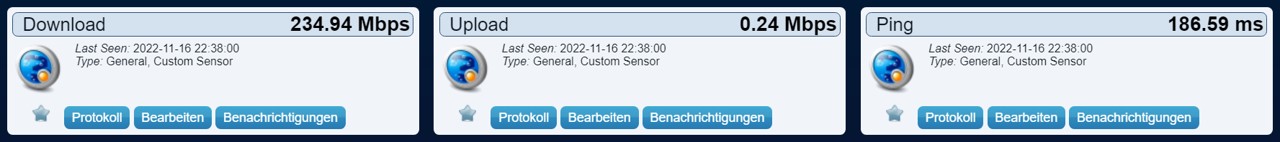

Hey my friends,
as I am new in posting because all I looked for I figured out I am now stuck somewhere related to this topic and hope you can help.
I have a python script which provides by regulare speedtests a csv (speedtest.csv) with 6 values like the following:
Date,Time,Ping (ms),Jitter (ms),Download (Mbps),Upload (Mbps)
11/09/22,07:40,9.93,3.37,925.84,48.61
As the script runs every 15 minutes there are several lines and I am interested in the last one to be transfered into domoticz. Here I only care about Download, Upload and Ping.
Due to this I tried to transfer the here provided dzVents to my needs but got stuck with the following:

Currently I dont get any errors but unfortunately nothing got transfered into domoticz as the dummy devices do not get any data.
My goal is to store every 15 minutes the last line in speedtest.csv to the devices so I get an overview of my speed data into domoticz.
I think I am not that far away but do something wrong by transformation of values and am missing timestamp as well but am not sure if domoticz registers the change with timestamp anyway?
Hope anyone can help me solve this!

Result looks good as I now can track my speedtest results in domoticz, see attachement. And as we also can see this will help to proof for my provider that this is not a 1mbit connection ;-))
Thanks for your suggestions and help!
