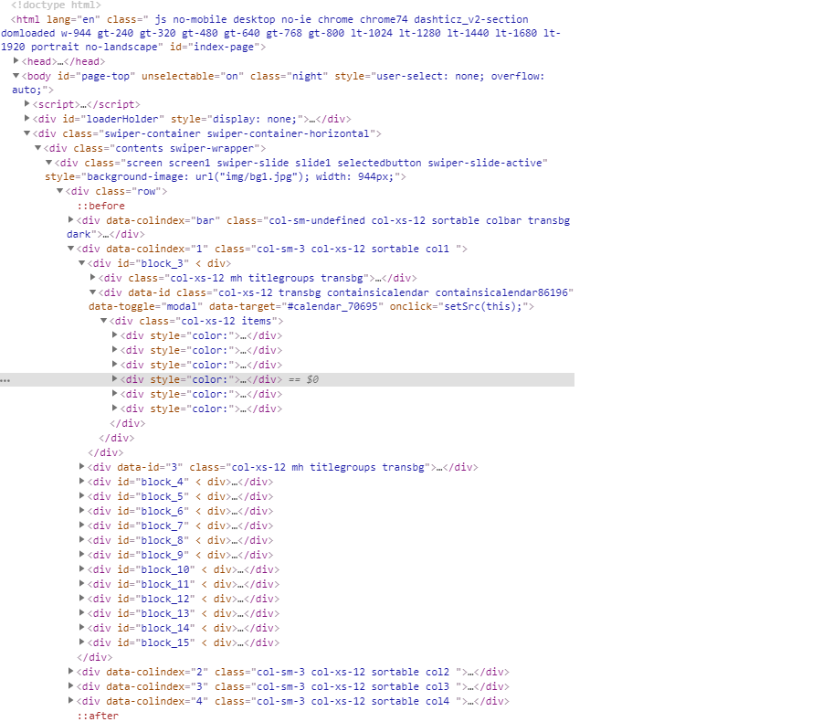

cant find.. is this helpful...
see atachment

Re: style box height
- x.png (63.73 KiB) Viewed 1085 times
Yes, that helps.
It seems to be a bug in Dashticz, which happens if you have an url defined in your calendar block.
Solution 1:
remove the url parameter
Solution 2:
In file js/calendar.js add two slashes in front of line 47, like this:
// calobject.attr('data-id', '');
If solution 2 is working then I'll make a fix for the next beta version of Dashticz.
do you mean the xxx part or the yyy part
calendars.fam = { key:'dvfam', maxitems: 6, title: 'Familie kalender', url: 'https://xxx',icalurl: 'yyyy/basic.ics' }
ok, when i remove xxx part the sizechanges work!
ok, the // also work!
thanks lokonli!
