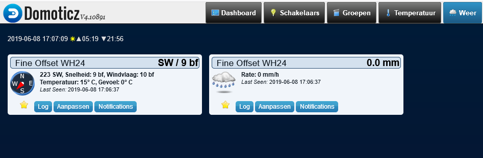

i editted Rtl433.cpp to include the wind and rain data presented by the WH24 like:
wind_dir_deg instead of wind_direction
rainfall_mm instead of rain
wind_speed_ms instead of wind_speed
gust_speed_ms instead of wind_gust
Now the recompile process toke much longer and included many objects, not sure why the difference with yesterday.
Anyway, after reboot, it now "sees" the wind (direction, speed and gust) data and rain data from the WH24 weatherstation, see picture.
Not sure if the wind data is accurate as it shows 10 /12 Beaufort (converted from m/s) windspeeds which seems somewhat "over the top" (8 Beaufort max.).
But its a start, now trying to "add" the UV, UVI and light (lux) data from the WH24 into Rtl433.cpp.
By the way, after recompile, i am now on V4.10891.

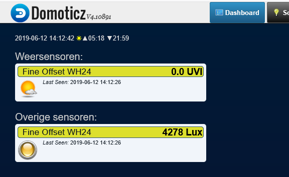

I editted Rtl433.cpp again to also "look" at the available UV, UVI and Lux data and added the SendUVSensor
and SendLuxSensor.
After recompile Domoticz it showed the both sensors and after some fiddling it seems to contain accurate
UVI and Lux data, see picture.
Now waiting for a sunny day....
Kees
and SendLuxSensor.
Kees
- uvi and lux sensor.png (24.77 KiB) Viewed 2920 times
