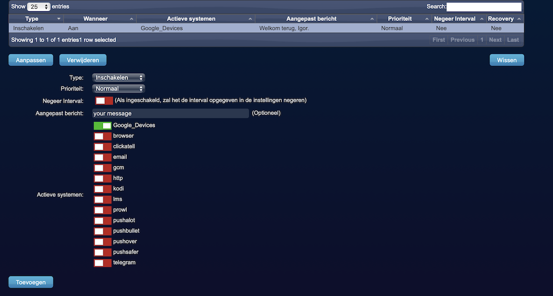

kniazio wrote: Wednesday 24 April 2019 22:06
Ihagens wrote: Wednesday 24 April 2019 21:58 spoken notifications work great!
Could you show me how these notifications work because I can not do this
if the plugin is setup correct you set them just as normal notifications.
Schermafbeelding 2019-04-24 om 22.16.58.png (369.45 KiB) Viewed 4139 times

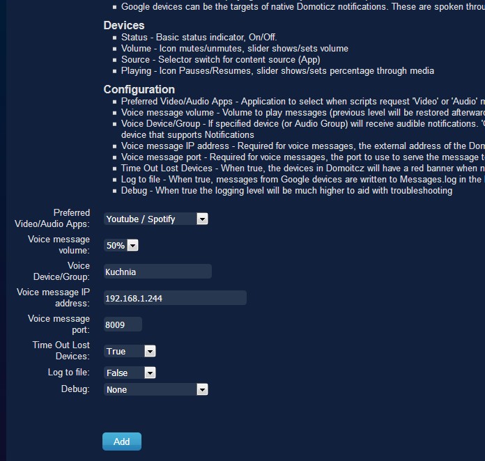

Okay, so the voice message is being created and the google device is being told to play it but it never comes back to Domoticz to get it.
This is usually caused by the IP address being wrong. Is the address you specified in the hardware page the IP of the computer that Domoticz is running on? It should be, also try setting the port to something random to make sure there isn’t a clash.
kniazio
Posts: 203
Joined: Thursday 06 October 2016 8:14
Domoticz version: 3.7243
Re: Python Plugin: Domoticz-Google-Plugin
Post by kniazio »
It's a shame to admit but the IP address was written for the google speaker :)
Everything works as it should
Thank you very much.
