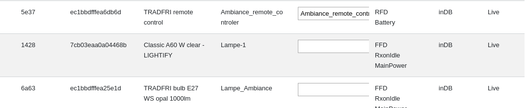

In attachment, the screenshot relating to the configuration file and my devices list.
I was particularly careful to select the zigate ( check button ), the remote control and the bulb in the same group. But despite all this I do not have the impression that the ID of the remote control is added to the configuration file. This is the reason why I will need help.

Re: Zigate and Tradfri 5 button remote in group
did you restart the plugin after having added the Ambiance_remote_controler ?

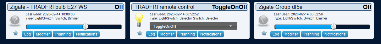

Currently, I have (luck) a group which according to the web interface should be correct.
Widgets behave normally, even the widget remote control.
In the logs I have the following error:
Error: (Zigate) manageIkeaTradfriRemoteLeftRight - undefined Color Mode for None
plugin group JSON :
0 :
Cluster : "0008"
Devices : Array[3] [{"Ep":"01","IEEE":"ec1bbdfffea25e1d","_NwkId":"e39d"},{"Ep":"01","IEEE":"00158d00021e13f0","_NwkId":"0000"},{"Ep":"01","_NwkId":"9020"}]
GroupName : "Zigate Group df5e"
WidgetStyle : "LvlControl"
_GroupId : "df5e"
Zgroup-lst :
0 : Object {"WidgetList":[{"Ep":"01","IEEE":"00158d00021e13f0","Name":"","ZDeviceName":"Zigate (Coordinator)","_ID":""}],"_NwkId":"0000"}
1 : Object {"WidgetList":[{"Ep":"01","IEEE":"ec1bbdfffea25e1d","Name":"Zigate - TRADFRI bulb E27 WS","ZDeviceName":"","_ID":17}],"_NwkId":"e39d"}
2 : Object {"WidgetList":[{"Ep":"01","IEEE":"ec1bbdfffea6db6d","Name":"TRADFRI remote control","ZDeviceName":"","_ID":18}],"_NwkId":"9020"}
Thank you for your help

Now from what you have shared, I think that all is right, and the group is correct, and only see as a Dimable group and not a Color one.
- Could you confirm that from Domoticz the widget piloting the Bulb is a Color Widget ?
- Could you kindly attach the export of Device List raw (json).
For now, I'm not sure that we have to enable any additional log.
This is where the problem is.
The Zigate - TRADFRI bulb E27 WS is a LighSwitch, Switch, Dimmer and not a Color Control. If I'm right you cannot change the White color either ?
Yes, it's the problem. Start / stop is ok. Dimmer light is ok, but button right and left for change white color don't work.
So the issue is here, not on the group. As the group just follow the device.
Did you try to remove the Bulb device and do the pairing again ?

Yes I understand. the widget should correspond to a white light dimming bulb with change white color (spectre).
