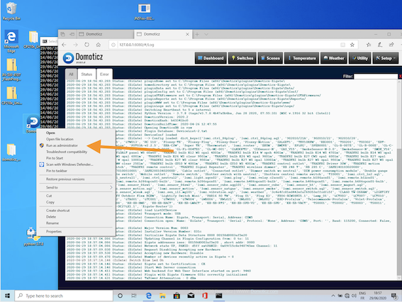

Make sure to run Domoticz with Administrator rights
Screenshot 2020-06-29 at 19.57.48.png (286.66 KiB) Viewed 696 times
