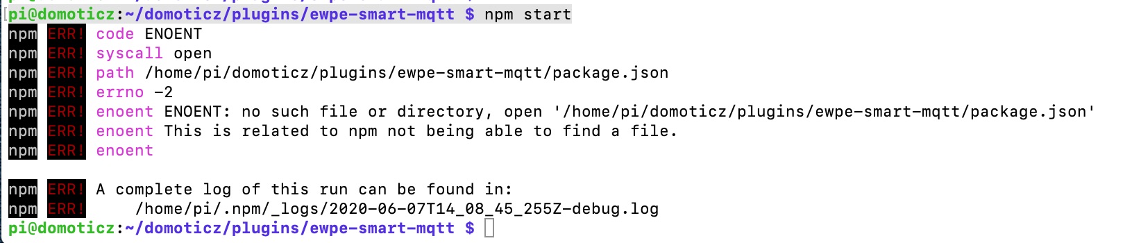

I'm trying to get the EWPE MQTT stuff to work as well.

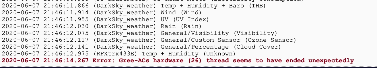

My MQTT is working as I can send info to the virtual switch which works, bu when trying to start npm I receive an error that the package.json file is missing.
This file is indeed not in the /domoticz/plugins/ewpe-smart-mqtt folder but it is also not on Github source https://github.com/stas-demydiuk/domoti ... qtt-plugin
Any help appreciated.

If you go to: https://github.com/stas-demydiuk/ewpe-smart-mqtt
You will find package.json as the last file
Did you install this?

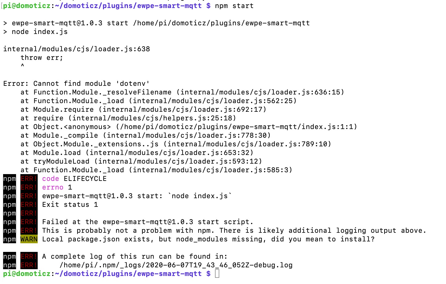

Re: Help with - EwpeSmart Air Conditioners via MQTT (Gree Smart)
Thanks for your quick reply.
Something is not completely clear to me.
What gets me confused here is the bridge+plugin and where/how they need to be installed.
Does the ewe Domoticz plugin+the ewpe MQTT need to be placed in the same directory?
Because that is what it seems when running both the commands;
ewpe-smart-mqtt bridge creates ewpe-smart-mqtt folder in domoticz/plugins//ewpe-smart-mqtt
git clone https://github.com/stas-demydiuk/ewpe-smart-mqtt
ewpe Domoticz plugin creates files in same folder domoticz/plugins
So in my case all the files are in the same folder now ewpe plugin+ewpe MQTT bdrige in /domoticz/plugins
When I run "npm start" I receive the below nmp error;
Domoticz log throws this error;
Which could make sense because npm is not working as expected.
Any thoughts?
Regards,
Any thoughts?
Regards,

1. Clone or download this repository :
2. Install dependencies :
3. Make initial configuration by setting environmental variables : See https://github.com/stas-demydiuk/ewpe-smart-mqtt
4. Run the bridge :
I assume, you don't install it in a Docker container.
To set an environment variable, do as follows: (if your Mosquitto broker runs on the same hardware as Domoticz)
Do that for all variables.
And then:
5. Clone repository into your domoticz plugins folder, as follows:
6. Restart domoticz
7. Go to "Hardware" page and add new item with type "EwpeSmart Air Conditioners via MQTT"
8. Set your MQTT server address and port to plugin settings

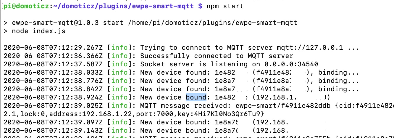

I made 3 out of 4 AC's work in Domoticz!
I think indeed the order of how things were setup I did wrong and that is why the AC's could not be found.
Once I ran npm install again in the domoticz/plugin/ewpe folder everything started to work.
Does npm need to run continuously in the background using "npm start &" command?
I was wondering if there is a limitation in the number of AC's that can be connected as it only finds 3 (3x found/3xbound, but missing nr 4)out of 4 of my AC's. All4 the AC's can be seen and used by the Gree EWPE App.
I have a Gree U-match with 4 AC's connected.
Further I see all the switches but where can I raise or lower the temperature using a switch?
And lastly if I reboot my raspi, do I need to manually restart npm or other services depending on MQTT?
Thanks for being so helpful, much appreciated!

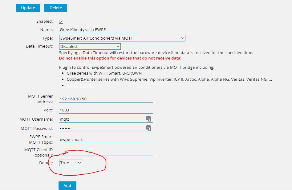

Hi Guys,
Well, it cost me a couple of nights, but finally I managed to set this up form my 2 Gree Fairy/Comfort X (GWH09ACC & GWH12ACC) ACs.
I was really happy with the success considering that was is my first home automation project, and also the first with RPI or Linux
(apart from Domoticz and Ubuntu installation)
So I thought to summarize and share how I did it, the issues I ran into, since the available tutorials were not enough form my experience level.
First of all, ewpe-smart-mqtt and EwpeSmart - Domoticz Python Plugin shall be installed in two different directories!
1. Followed th steps from here: https://github.com/stas-demydiuk/ewpe-smart-mqtt
My install folder is the same level where the domoticz folder is: /home/pi
Here you also have to install npm & nodejs.
ARMv6 (Pi Zero) is not listen on nodejs.org currently, you have to google for the link (node js armv6), e.g.:
Extract tar.xz
Install is just copy:
--> in 3. Environmental variables which differs from the default in your case can be set temporarily (example):
BUT you better add permanently by editing ewpe-smart-mqtt/index.js, otherwise it is lost after restart:
2. Installed the plugin in domoticz/plugins: https://github.com/stas-demydiuk/domoti ... qtt-plugin
--> I got several problems at this point, check your Domoticz log if the python scripts are running well, if not:
make scripts executable in domoticz/plugins/ewpe-smart-mqtt:
install libpython:
install python3-dev:
After a full restart the switches became available in Domoticz (under Devices), and I could switch the ACs.
Note, at this point, after every restart you have to start manually the ewpe-smart-mqtt:
To fix this you have to run it as a service, for this I followed the instructions linked by @FireWizard :
https://www.axllent.org/docs/nodejs-ser ... qus_thread
This is the specific code for my ewpe-smart-mqtt.service with npm:
Last thing I needed was to add a startup delay to Domoticz, to wait for other processes to start, otherwise I got an error message on boot:
add ARGS to define delay, 5 seconds in my case:
ToDo:
As I've experienced it does not reconnect in case of network error (router restart), but this could be managed with the Domoticz script I guess, but suggestions are welcomed
Thank you guys for making this, and the support to all the sources I've worked from.

Making the NPM start does not work, what now ?

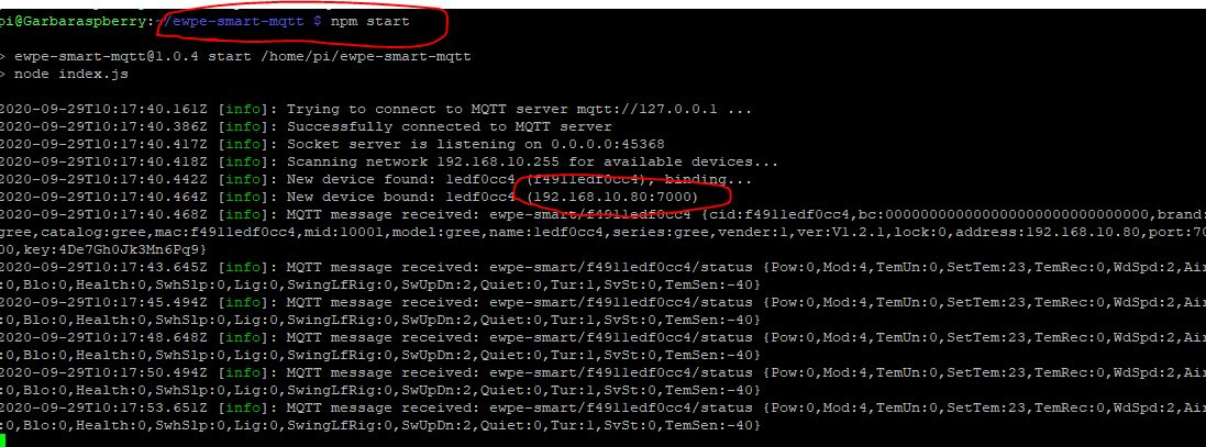

The NPM should be started from the folder /home/pi/ewpe-smart-mqtt (not from /home/pi/domoticz/plugins/ewpe-smart-mqtt !)
After starting "npm start" you should see something like this: You can see that the Air Conditioner has been discovered under 192.168.10.70:7000 and all the parameters (temperature etc) are there.

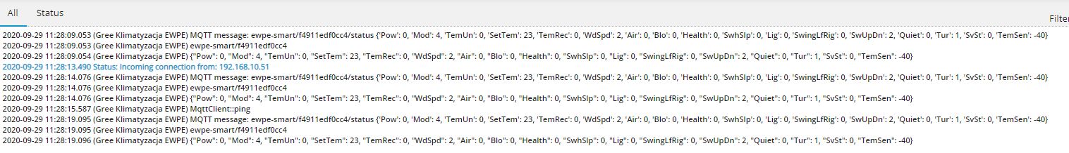

NPM started and the Air conditioner was discovered but in Domoticz nothing happened, what now ?
Turn on debug in the Domoticz plugin: Check the logs in Domoticz. At the begining there should be also an information about connecting to MQTT and later there should be also something like this:
