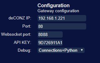

2019-02-03 16:17:57.868 Error: (ConBee) WebSocket Disconnected, reconnexion !
2019-02-03 16:17:57.869 Error: CConnection_connect, connect request from 'ConBee' ignored. Transport is connecting.
2019-02-03 16:17:57.970 Error: (ConBee) deCONZ error :{'error': {'address': 'api/1234567890/lights', 'description': 'unauthorized user', 'type': 1}}Any help on resolving this?

2019-02-03 18:08:45.621 Status: (ConBee) ### deCONZ ready
Now it works... Big thanks!
Edit... Was to quick...
Connections seems be OK but got this in the logs:
And state of devices does not change ..
2019-02-03 18:20:51.089 Error: (ConBee) WebSocket Disconnected, reconnexion !
2019-02-03 18:20:51.089 Error: CConnection_connect, connect request from 'ConBee' ignored. Transport is connecting.“When you eliminate the impossible, whatever remains, however improbable, must be the truth.” -Spock in Star Trek VI

Wich one port you have set for websocket ? 8088 ?
- Minglarn
- Posts: 214
- Joined: Friday 21 August 2015 19:27
- Domoticz version: v3.8153
- Location: Stockholm / Sweden
Re: Python Zigbee plugin, deCONZ bridge (Using Conbee or Raspbee)
Yes...
