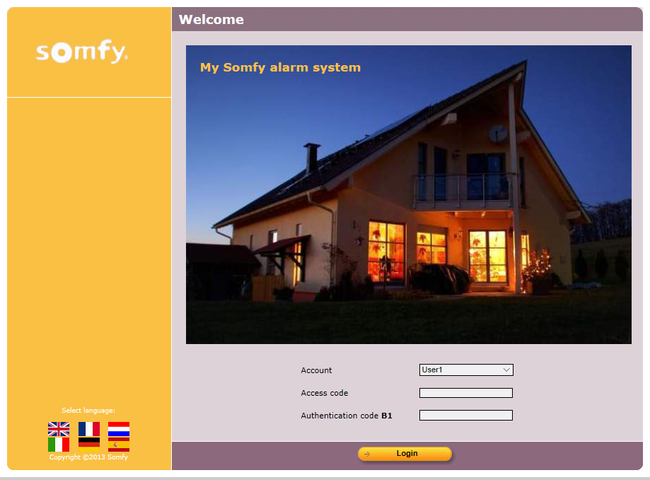

@clumpton; the lookup table is provided and has been adapted by me. It consists of numbers.
It can ineed be from A1 to F5.
10.0.0.112/gb/login.htm looks like this:
login page.png (374.63 KiB) Viewed 2197 times

OK, so it's not picking up the "B1", mainly because it's looking for "Code d'authentification" rather than "Authentication code".

It should echo the access code reference (A1, B5 etc.).

My bad!!
Remove the extra " at the end of this line
		echo " Retrieving access code""

That fixes the error indeed...
However; nothing happens. I see a lot of echo lines, which should at least be displayed.
What happens if you run it?
Been adding some test echos, it does seem to go through the whole script in a way.
edit: wait a minute... is it even supposed to do something without command line options?
Probably isn't, i get some continuous response now:

Now it's a matter of debugging i guess...

added a couple of " " to lines that errored out...
One step further…
