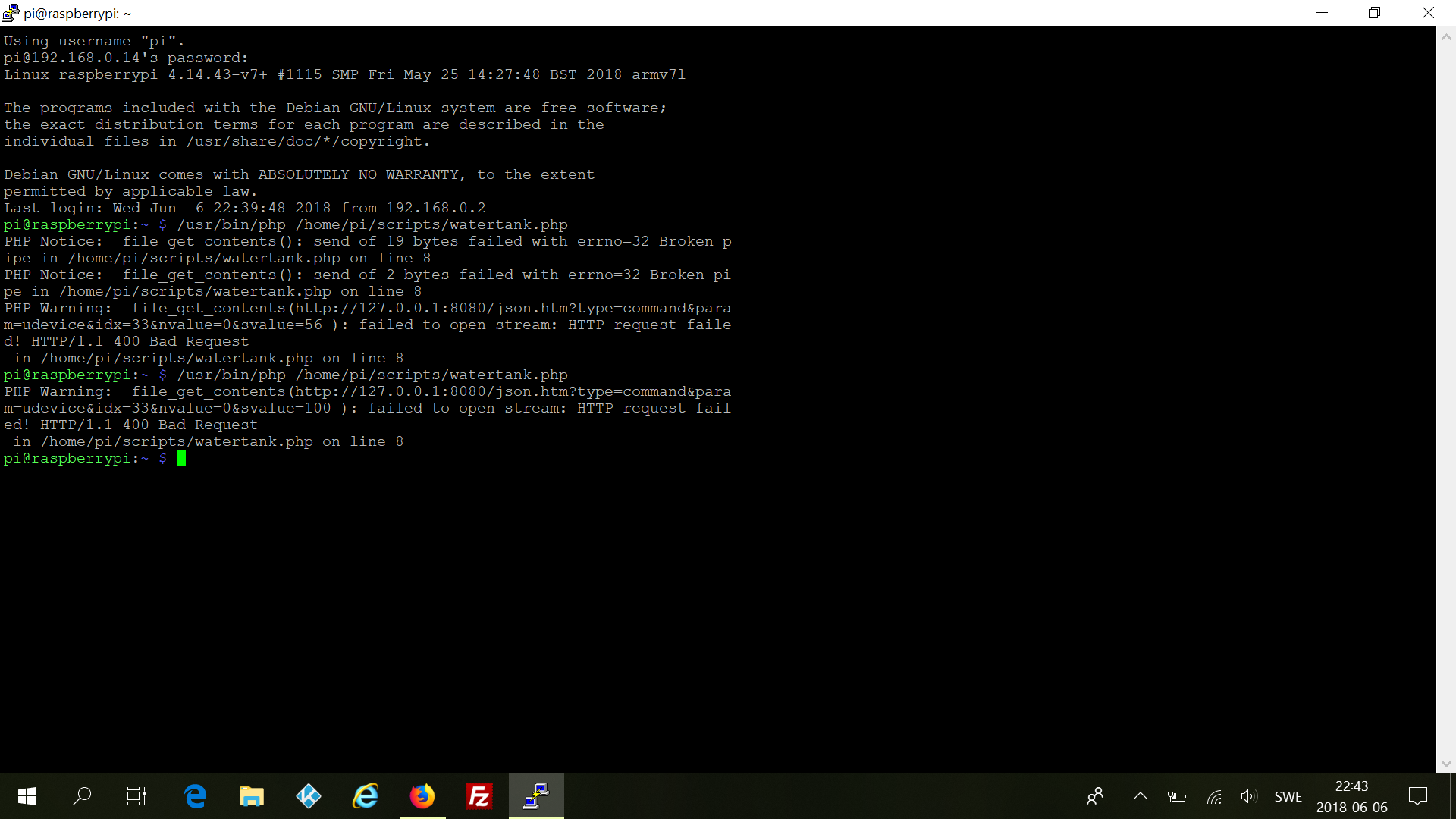

still error but in line 8. thanks for taking time anyway!
- Screenshot (8).png (188.86 KiB) Viewed 3117 times

Re: Water tank level (from other webserver)
What if you past thag url in a browser and just change the ip address?

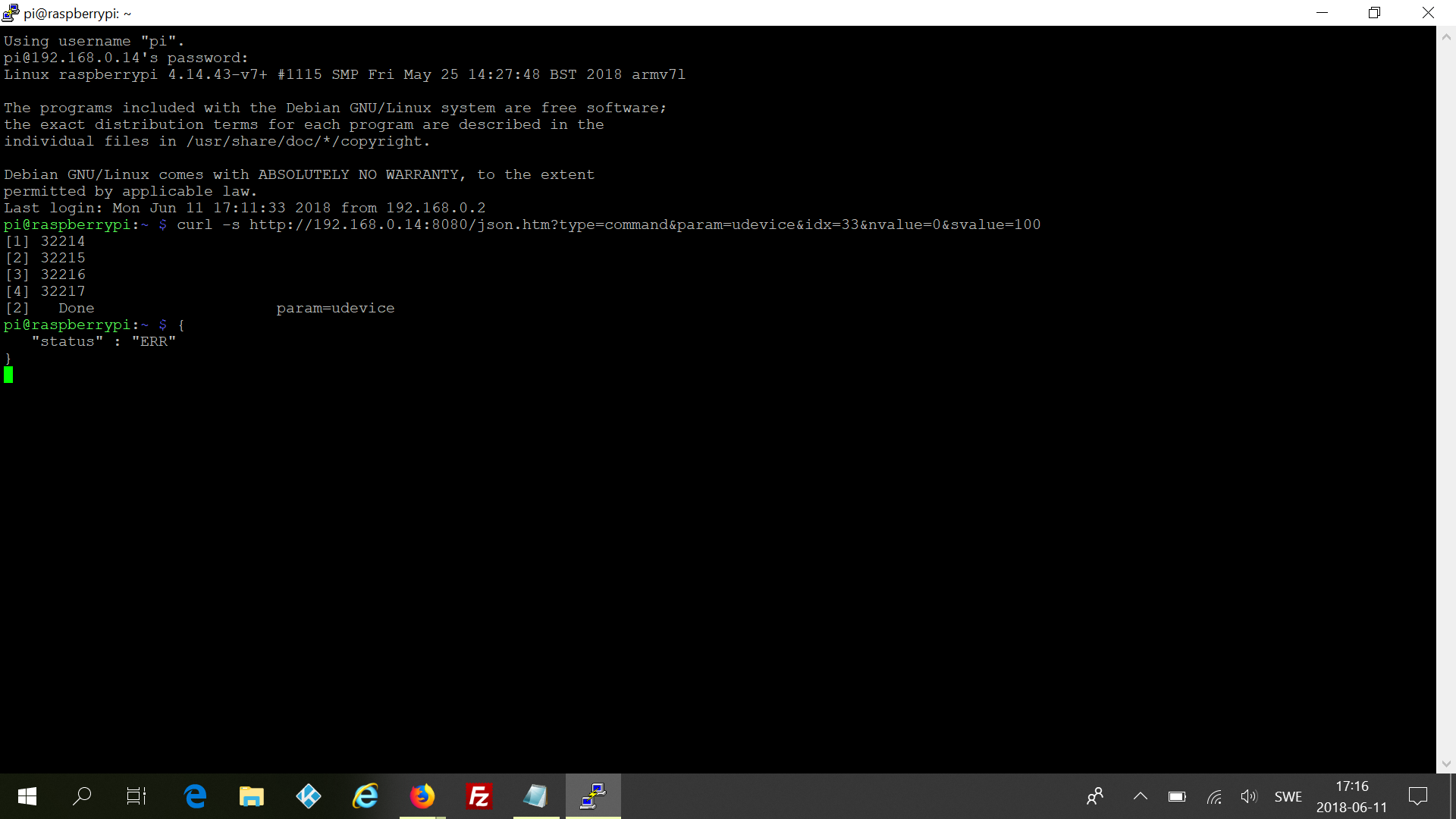

Tarzan737
- Posts: 60
- Joined: Friday 01 June 2018 20:32
you mean like this?
- Screenshot (9).png (170.13 KiB) Viewed 3045 times
- Egregius
- Posts: 2592
- Domoticz version: v2024.7
- Location: Beitem, BE
No. This command:
curl -s "url..."
curl -s "url..."
Tarzan737
- Posts: 60
i get this...
- Screenshot (10).png (133.17 KiB) Viewed 3032 times

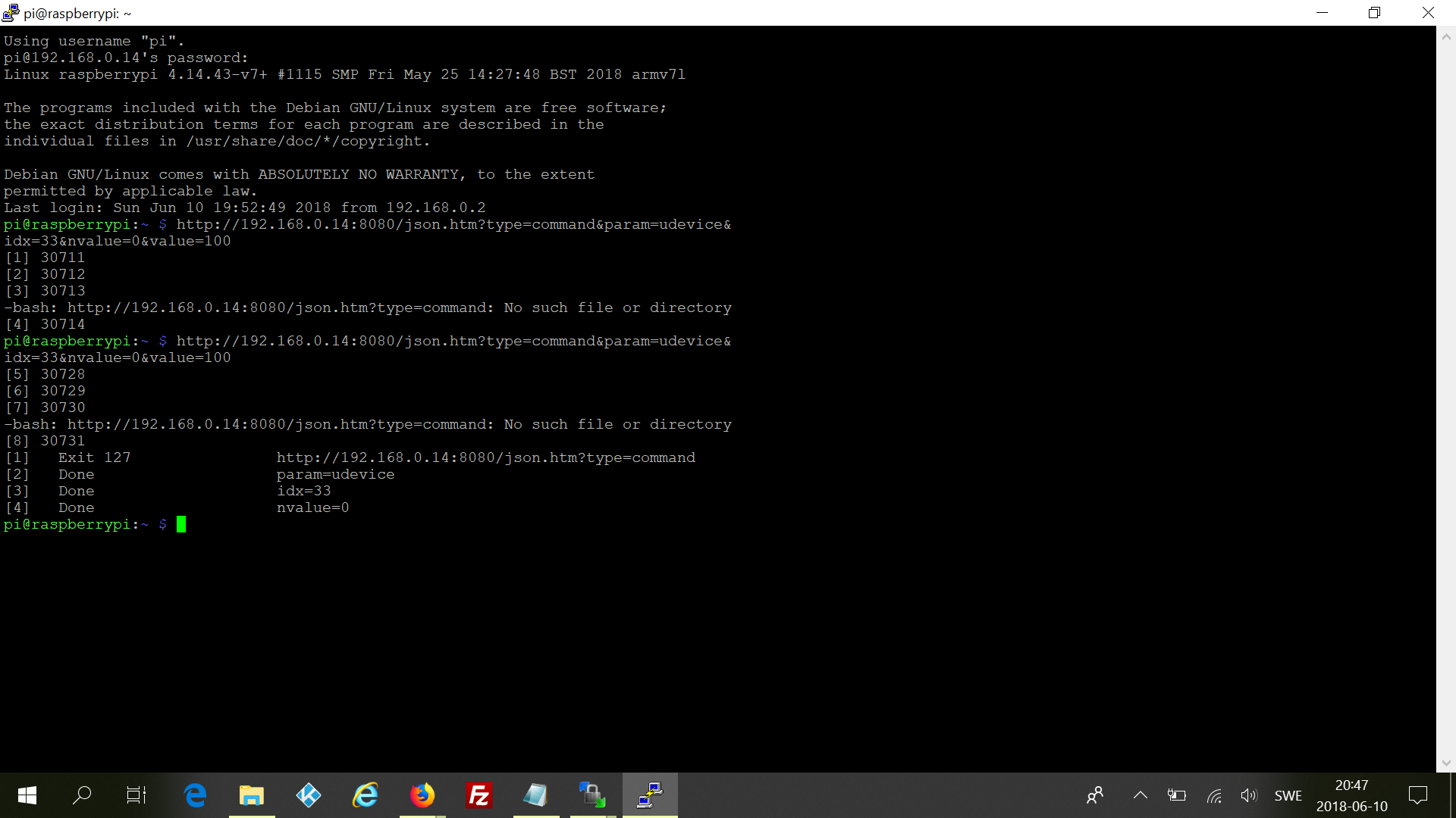

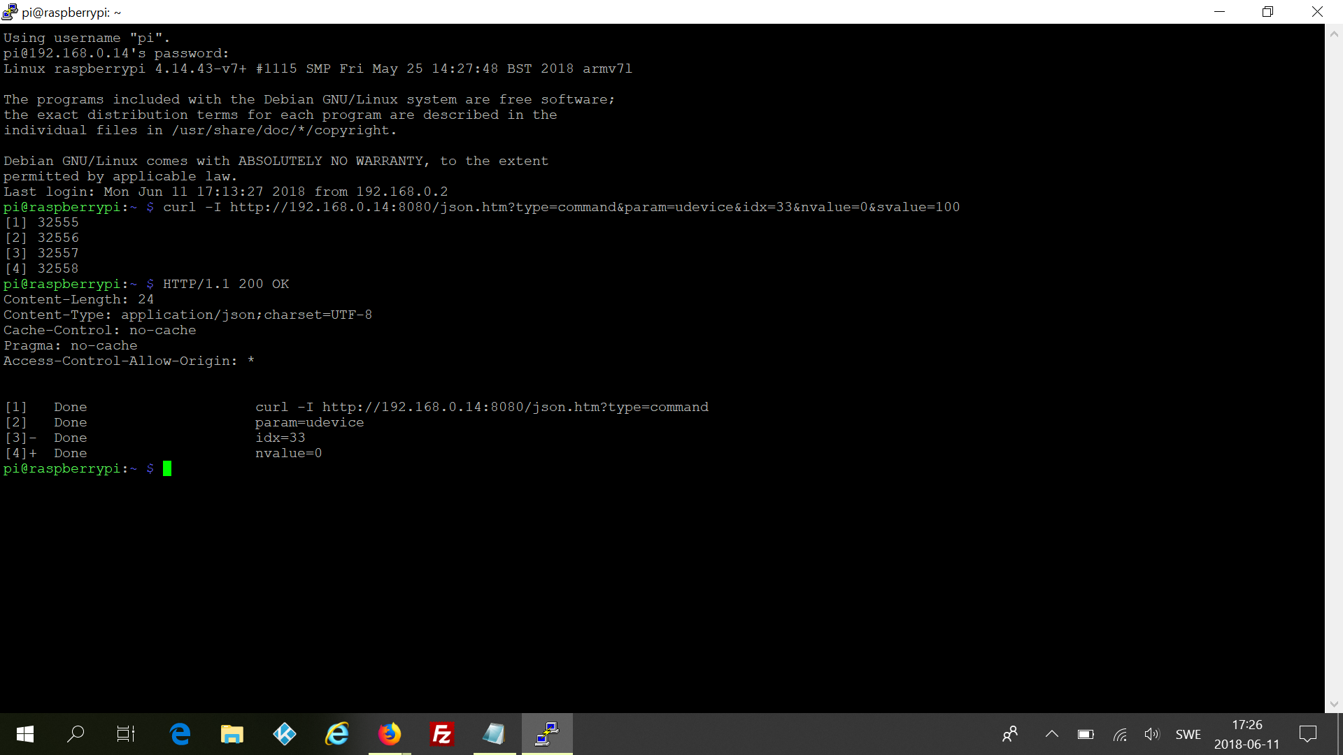

Tarzan737
- Posts: 60
tried curl -I to...
- Screenshot (12).png (151.79 KiB) Viewed 3032 times
- Egregius
- Posts: 2592
You need to place the url between quotes...
Also, please try google... He knows a lot
Tarzan737
- Posts: 60
ahh crap
sorry again...
anyway.. then i get status ok and title update device....
other words.. it works like that!!

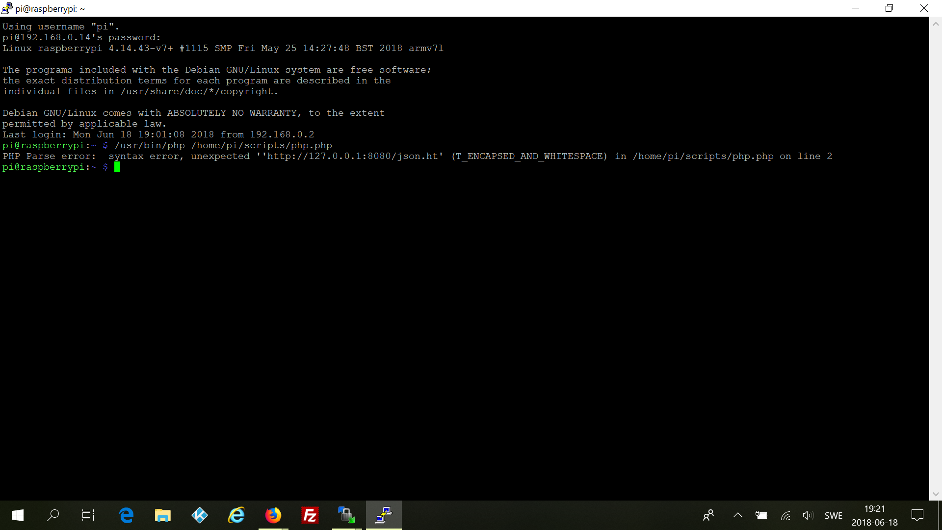

Tarzan737
- Posts: 60
i have actually tried this before
and then i get error on line 2 instead...
<?php
file_get_contents('http://127.0.0.1:8080/json.htm?type=command¶m=udevice&idx=33&nvalue=0&svalue=100);
