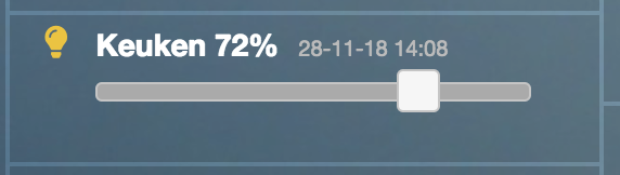

I get the error when I change the light dimmer value, the slide bar, see screenshot
Screen Shot 2018-11-28 at 14.08.49.png (69.33 KiB) Viewed 1623 times
I believe this is the bug we are discussing.

rgroothuis wrote: Wednesday 28 November 2018 14:11 I believe I found the problem, I get the error message on both the Mac Chrome browser as on the tablet.
Good!
The dimmer indeed creates a lot of network requests to Domoticz which may result in this error.
Probably it already is solved with the PR on github. See:
https://github.com/Dashticz/dashticz_v2/pull/405
We have to wait for Rob Geerts to releases a new beta version.
