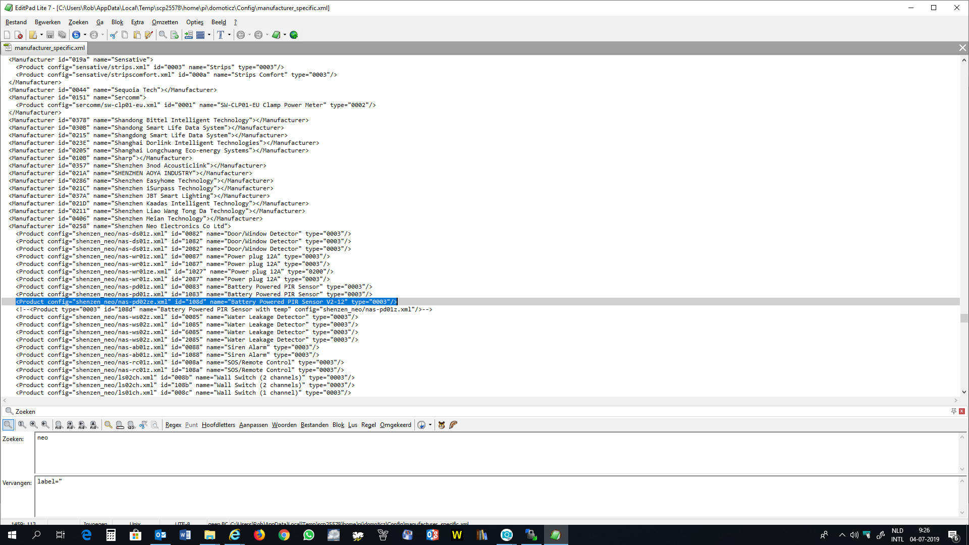

Re: neo coolcam motion sensor with temp sensor, unknown in domoticz
But you also need to edit the manufacturer_specific.xml
<Product type="0003" id="108d" name="Battery Powered PIR Sensor V2" config="shenzen_neo/nas-pd02z.xml"/> <!-- pd02z.xml --> Code: Select all
<Product type="0003" id="108d" name="Battery Powered PIR Sensor V2" config="shenzen_neo/nas-pd02ze.xml"/> <!-- pd02z.xml --> RPi3 B+, Debain Stretch, Domoticz, Homebridge, Dashticz, RFLink, Milight, Z-Wave, Fibaro, Nanoleaf, Nest, Harmony Hub, Now try to understand pass2php

Change the manufacturer
tonbor
- Posts: 162
- Joined: Monday 17 February 2014 9:12
Just add a "E" with the name, see picture, config="shenzen_neo/nas-pd02ze.xml"
That's it, but problem with ozw 1.6 -> 2019-07-04 09:09:03.438 Error: OpenZWave: Value_Changed: Tried adding value, not succeeded!. Node: 5 (0x05), CommandClass: ALARM, Label: Previous Event Cleared, Instance: 1, Index: 256
but there is work to do voor domoticz team, see other subject about this https://www.domoticz.com/forum/viewtopi ... =6&t=28308
with an new update of domoticz you have to change manufacturer_specific.xml again, I can not help that……….
Openzwave [openzwave] open-zwave Commit: Add support for "temperature" model of NAS-PD02Z https://github.com/OpenZWave/open-zwave/issues/1866
