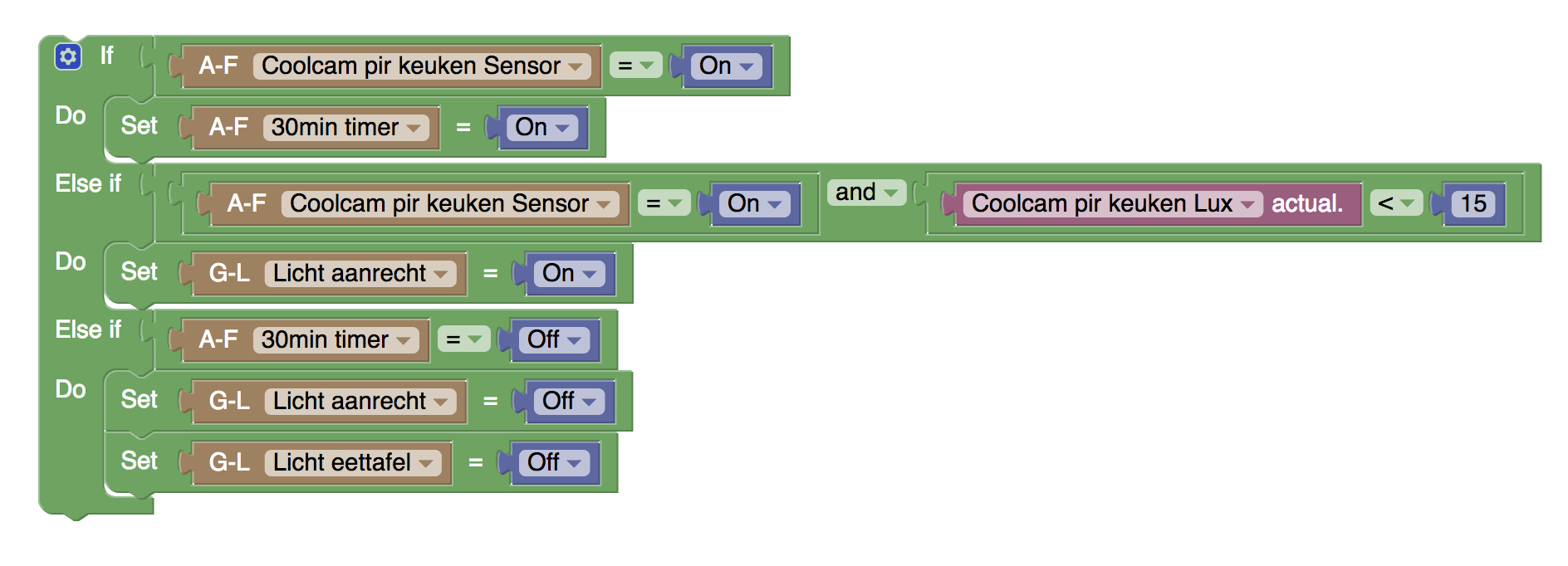

With the example of Bizziebis, I've created this. This way the lights are switched of if 30 mins no movement, even if they are switched on manual.
Schermafbeelding 2018-05-13 om 11.23.00.png (160.96 KiB) Viewed 1334 times
