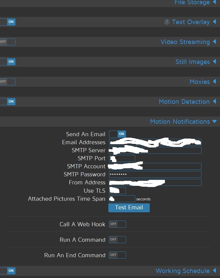

I forgot to mention. On motion detection, motionEye offers many options : from storing snapshots/video, sending email, ... to launching a script or a web url (see screenshot below). So, I assume that your image processing can be used (you even can for example switch on/off a Domoticz device from motionEye).
You can also use motionEye only for camera live display without using its motion detection feature.
