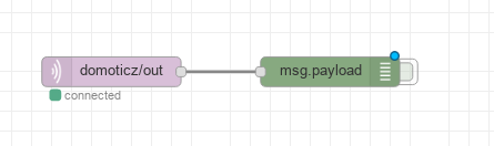

2. The next thing we do is that we drag and drop from the output section the debug node.
You may double click on it and give it a name but that is optional
3. Draw a line from the output of the MQTT In node to the debug node, so that you have the following flow:
Screenshot_Node Red MQTT debug.png (6.69 KiB) Viewed 3843 times
Do not forget to press Deploy

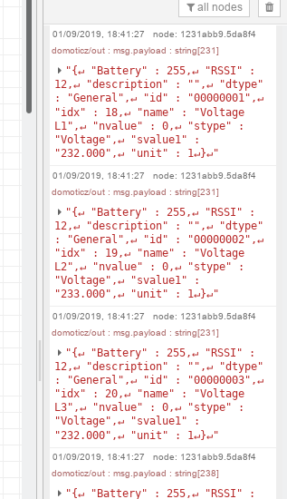

3. If you go now to the debug pane
Press Ctrl+ g and the d or click on the debug symbol, right beside info.
If everything is succesfull you will see debug output from domoticz.
Screenshot_Node Red debug output.png (41.33 KiB) Viewed 3843 times
If you can see output from Domoticz you have checked that both Domoticz and Node Red can communicate with your broker.
But you have verified already a couple of things, so maybe you find it already yourself.

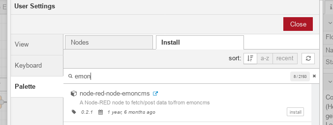

Before you can use the script you have to install an additional node in Node Red, EmonCMS as follows
Go to the menu at the top right (3 bars) and click Manage palette.
Go to the Install tab and search for EmonCMS.
Screenshot_node emoncms.png (19.72 KiB) Viewed 3843 times
If you cannot succeed on this road, you can try to scrape the website.

Yes I managed to open Node Red web interface but had no clue what to do. your instructions are clear on this.
I can see debug messages in Node-red so communication between Domoticz / broker and broker / node-red is working.
Next step is to see what I can do with part 2 of you support.

You see at the right you have an unknown node: emoncms. That is because the emoncms node has not been installed and we probably don't need it.
The last step is to remove that unknown node and insert a debug node.
See the picture below.
