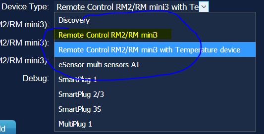

@Kruu
do you have selected the right device type ??
