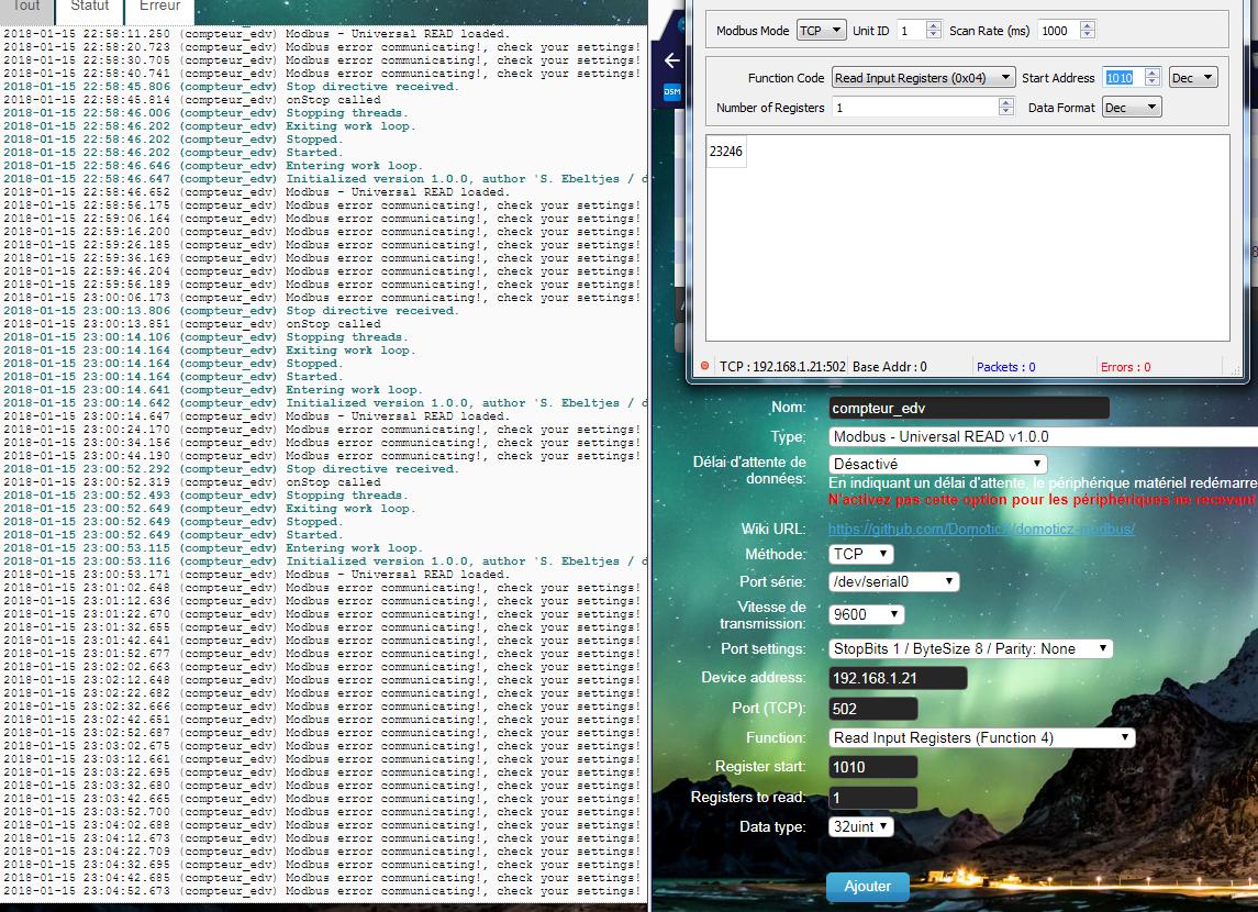

i can't setup modbus-read in TCP mode, may be you can help me?
The modbus counter work's fine, it have count 232,46 m3 of water (can we adjust the comma decimal in your plugin?)
i can read the input 1010 in 32uint type data with a modbus sofware, ip adress 192.168.1.21 port 502
but don't works with those parameters in python plugin
2018-01-15 23_05_00-Domoticz.jpg (278.33 KiB) Viewed 5366 times

Your TCP config seems OK!
1) Have you installed Pymodbus correctly for python3?
2) Are you using the right modbus function (4) to read the data out of the device?
3) To read a 32uint you need 4 bytes, thus you need to read out 2 registers (not 1) :geek:

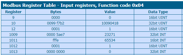

my modbus register table
2018-01-16 22_59_35-HWg-PWR.png (9.43 KiB) Viewed 5329 times

In the log above you still using v1.0.1 wich has the bug "Data type=32int" (in v1.0.2 it is corrected to: Data type=32uint) :shock:
please after download and overwrite plugin files, restart domoticz:
sudo service domoticz.sh restart
And i see in your register table it should be 32bit INT (not UINT) so i will add more decoding options in v1.0.3 to try out! :D

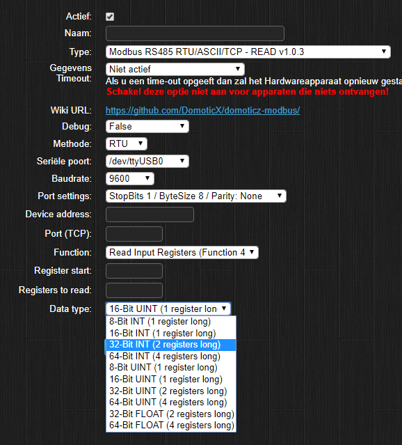

I have updated the READ to v1.0.3, added more decoding options :geek:
Also in your "Modbus example window" you are reading 1010 (and the program adds offset +1?) so you are actually reading register 1011 16Bit INT? (that explains the number of registers=1)
Ps. what kind of Modbus TCP unit do you have? (i only have RTU stuff here)
domoticz read v1.0.3 decode options.png (104.4 KiB) Viewed 5323 times

2018-01-17 21:19:41.485 Incoming connection from: 127.0.0.1
2018-01-17 21:19:48.737 (compteur_edv) Calling message handler 'onHeartbeat'.
2018-01-17 21:19:48.737 (compteur_edv) MODBUS DEBUG TCP CMD - Method=tcp Address=192.168.1.21 Port=502 Register=10 Registers to read=2 Data type=32uint
2018-01-17 21:19:48.738 (compteur_edv) Modbus error communicating!, check your settings!
2018-01-17 21:19:48.738 (compteur_edv - ModbusDEV-READ) Updating device from 0:'0' to have values 0:'0'.
2018-01-17 21:19:48.749 (compteur_edv) Modbus error decoding (or recieved no data)!, check your settings!
2018-01-17 21:19:48.749 (compteur_edv - ModbusDEV-READ) Updating device from 0:'0' to have values 0:'0'.
2018-01-17 21:19:58.743 (compteur_edv) Calling message handler 'onHeartbeat'.
with register 1009 /32b INT
2018-01-17 21:22:25.742 (compteur_edv) Started.
2018-01-17 21:22:26.248 (compteur_edv) Entering work loop.
2018-01-17 21:22:26.249 (compteur_edv) Initialized version 1.0.4, author 'S. Ebeltjes / domoticx.nl'
2018-01-17 21:22:26.304 (compteur_edv) Debug log level set to: 'true'.
2018-01-17 21:22:26.304 (compteur_edv) 'Mode3':'S1B8PN'
2018-01-17 21:22:26.304 (compteur_edv) 'Mode5':'2'
2018-01-17 21:22:26.304 (compteur_edv) 'Author':'S. Ebeltjes / domoticx.nl'
2018-01-17 21:22:26.304 (compteur_edv) 'DomoticzBuildTime':'2018-01-15 13:01:28'
2018-01-17 21:22:26.304 (compteur_edv) 'Mode2':'9600'
2018-01-17 21:22:26.304 (compteur_edv) 'DomoticzHash':'4ec5e160'
2018-01-17 21:22:26.304 (compteur_edv) 'Mode4':'debug'
2018-01-17 21:22:26.304 (compteur_edv) 'HardwareID':'13'
2018-01-17 21:22:26.304 (compteur_edv) 'DomoticzVersion':'3.8809'
2018-01-17 21:22:26.304 (compteur_edv) 'Username':'4'
2018-01-17 21:22:26.304 (compteur_edv) 'HomeFolder':'/home/pi/domoticz/plugins/modbus-read/'
2018-01-17 21:22:26.304 (compteur_edv) 'Address':'192.168.1.21'
2018-01-17 21:22:26.304 (compteur_edv) 'Password':'1009'
2018-01-17 21:22:26.304 (compteur_edv) 'SerialPort':'/dev/serial0'
2018-01-17 21:22:26.305 (compteur_edv) 'Version':'1.0.4'
2018-01-17 21:22:26.305 (compteur_edv) 'Port':'502'
2018-01-17 21:22:26.305 (compteur_edv) 'Mode1':'tcp'
2018-01-17 21:22:26.305 (compteur_edv) 'Name':'compteur_edv'
2018-01-17 21:22:26.305 (compteur_edv) 'Mode6':'32int'
2018-01-17 21:22:26.305 (compteur_edv) 'Key':'Modbus'
2018-01-17 21:22:26.305 (compteur_edv) Device count: 1
2018-01-17 21:22:26.305 (compteur_edv) Device: 1 - ID: 173, Name: 'compteur_edv - ModbusDEV-READ', nValue: 0, sValue: '0'
2018-01-17 21:22:26.305 (compteur_edv) Device ID: '173'
2018-01-17 21:22:26.305 (compteur_edv) Device Name: 'compteur_edv - ModbusDEV-READ'
2018-01-17 21:22:26.305 (compteur_edv) Device nValue: 0
2018-01-17 21:22:26.305 (compteur_edv) Device sValue: '0'
2018-01-17 21:22:26.305 (compteur_edv) Device LastLevel: 0
2018-01-17 21:22:26.305 (compteur_edv) Modbus RS485 RTU/ASCII/TCP - Universal READ loaded.
2018-01-17 21:22:35.778 (compteur_edv) Calling message handler 'onHeartbeat'.
2018-01-17 21:22:35.778 (compteur_edv) MODBUS DEBUG TCP CMD - Method=tcp Address=192.168.1.21 Port=502 Register=1009 Registers to read=2 Data type=32int
2018-01-17 21:22:35.779 (compteur_edv) Modbus error communicating!, check your settings!
2018-01-17 21:22:35.779 (compteur_edv - ModbusDEV-READ) Updating device from 0:'0' to have values 0:'0'.
2018-01-17 21:22:35.789 (compteur_edv) Modbus error decoding (or recieved no data)!, check your settings!
2018-01-17 21:22:35.789 (compteur_edv - ModbusDEV-READ) Updating device from 0:'0' to have values 0:'0'.
2018-01-17 21:22:45.774 (compteur_edv) Calling message handler 'onHeartbeat'.
