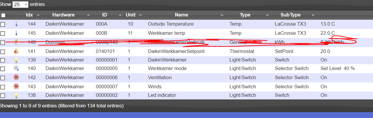

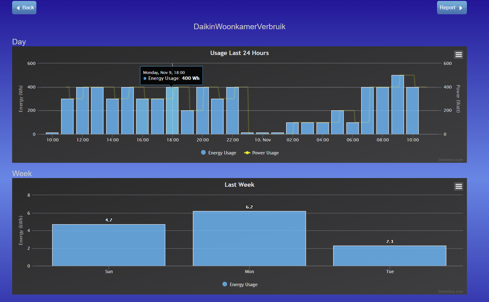

Last week I received my three daikins.
The default domoticz plugin works perfectly well for my needs, but was missing power usage, so I created a dzVents script for that:

Normally I create scripts in english, but this time I started of of the wrong foot, so it's in Dutch.
What you'll need to do is create a Dummy electrical "instant+counter" device.
Change the device id in this line: " local DaikinVerbruikWoonkamer = dz.devices(151) -- Elektrische Dummy Counter"
Change the IP in this line " url = 'http://192.168.0.113/aircon/get_day_power_ex',"
If you have multiple daikins, also change this line "httpResponses = { 'energyRetrievedWoonkamer' }" to something unique.
And match it with this line "callback = 'energyRetrievedWoonkamer'"
About the script, I had in running for one day, and it seems to give the same results as the app. However, it's has some quirks. This is also my first lua script.

            dz.log ('TotalTodaySamen: '      .. TotalToday)
            dz.log ('TotalTodaySamenWatth: ' .. TotalTodayWatth)
            dz.log ('LastHourWatth: '        .. LastHourWatth)
            --local NewTotal = DummyDaikinConsumption.WhTotal +  TotalTodayWatth
            local DaikinConsumptionLiving_room = dz.devices(99) -- Electric Dummy Counter
            dz.log ('Old Total of device DaikinConsumptionLiving_room = '  ..  DaikinConsumptionLiving_room.WhTotal)
            -- Updating device with Consumption per Hour
            NewTotal = DaikinConsumptionLiving_room.WhTotal +  LastHourWatth
            dz.log ('New Total = '  ..  NewTotal)
            -- Device update
            DaikinConsumptionLiving_room.updateElectricity ( LastHourWatth , NewTotal )
            -- Of per Day
             --NewTotal = DummyDaikinConsumption.WhTotal +  TotalTodayWatth
            --DummyDaikinConsumption.updateElectricity ( TotalTodayWatth , NewTotal )
I hope that now translation is Ok ...(!)

fenx2002 wrote: Wednesday 11 November 2020 10:23 i added in domoticz one split and i have 8 modules but only switches
Could you please create a screenshot?
You should have these devices when adding one unit:
