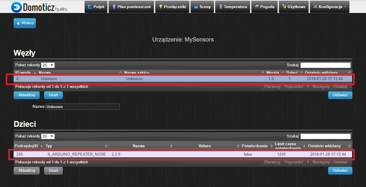

Finally i update FW on RPI3 to version 4.14.15 (this is new FW from branch name NEXT). Then i compile and build MySensors Gateway with connection Serial on my RPI3 and it start working ok. Now i dont have info about port closed.
./configure --my-transport=rfm69 --my-rfm69-frequency=868 --my-is-rfm69hw --my-gateway=serial --my-serial-is-pty --my-serial-pty=/dev/ttyUSB30
make
sudo make install
sudo systemctl enable mysgw.service
Then i programm my node on Arduino Mini Pro with radio RFM69HW with this sketch. I use on gateway and sketch library MySensors 2.2.0. But after programm node is found on my gateway but not show switch relay from node. Only show repeater. Look:

SweetPants
Re: MySensors Gateway on GPIO RPi 3 with RFM69HW-Problem
Post by SweetPants »
Tried to "Enable New Hardware" in domoticz settings menu? ChildID 255 is your gateway. So you never learned a node yet
piokuc
Post by piokuc »
Enable New Hardware nothing change...
SweetPants
piokuc wrote: Sunday 28 January 2018 21:27 Enable New Hardware nothing change...
Hmm, That's weird, i'm running the same MySensors GW on RPI 2 version 2.2.1-alpha (used to run 2.2.0-rc2), and nodes 2.2.0-beta and 2.2.0-rc2 without any issues. After enabeling hardware you have to trigger a message from the node before Domoticz pick's it up.
