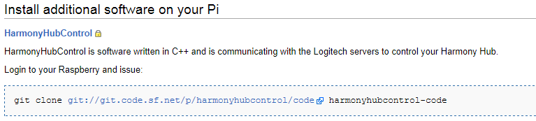

Hi guys,
I'm stuck :(
Did everything in the wiki, but the last step gives me following error:
make: cc: Command not found
make: *** [HarmonyHubControl.o] Error 127
This happens when I execute: make HarmonyHubControl
Any ideas how I can work around this?

joske522 wrote:Hi guys,
I'm stuck :(
You ned to install GCC on your raspberry.
Please use google on how to do that.
