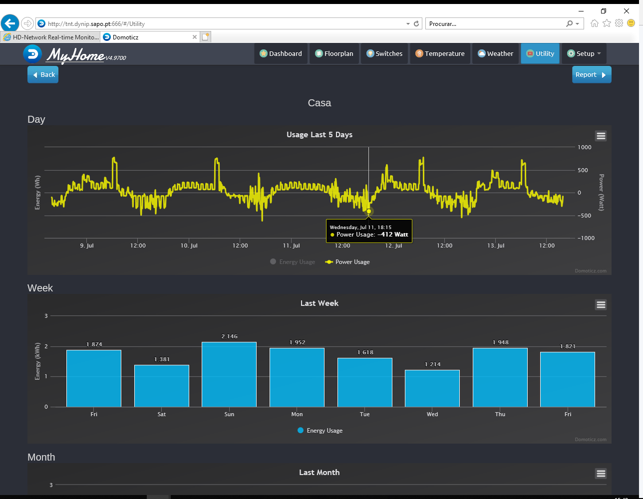

gajotnt
- Posts: 70
- Joined: Monday 06 February 2017 12:48
- Domoticz version: V4.9700
- Location: Azores
Re: LUA – Virtual Solar Battery: simulate the presence of a battery for storing harvested solar energy
Awesome idea :O
I dont have a P1 meter, but have 3 solar panels and a SDM120 MODBUS that gives me negative values when im sending energy to the grid.
Can you make a version of your script where it gets the information from the SDM120 dummy device (that has positive and negative values) and sends only the positive values to another Virtual Energy counter (that would be the "Used Energy") and another Virtual Energy counter that would receive the negative values convert them to positive and would be the "Wasted Energy".
That way one could better understand how to use 100% of the generated energy.
I think it would be an simpler version of your script, been trying to figure out how to adapt it to my needs, but programming isnt my strong suit :/

gajotnt
- Posts: 70
- Location: Azores
It is a dummy usage meter (kWh)
Maybe you can take a look at this post were I explain what im looking for and have a partial working code:
viewtopic.php?f=61&t=24142#p186211

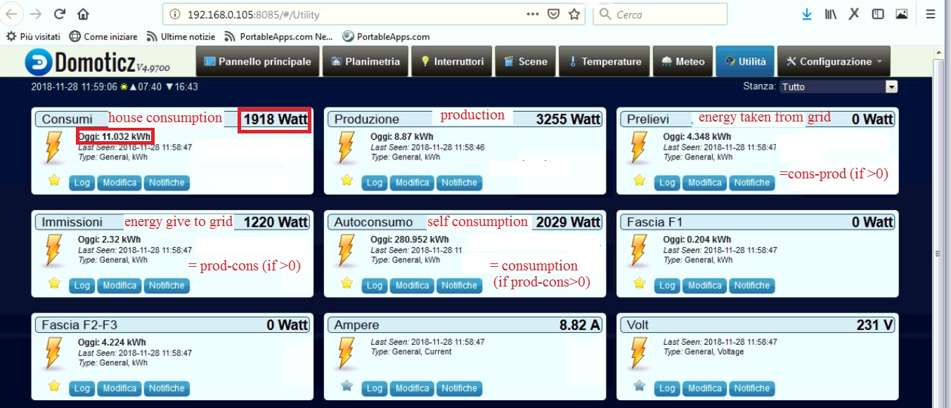

megamarco83
- Posts: 109
- Joined: Friday 21 September 2018 15:07
Re: Virtual Solar Battery: simulate the presence of a battery for storing harvested solar energy
hi, thanks for the script.McMelloW wrote: Thursday 08 March 2018 10:54 With a little dzVent script, all 6 meter values of the P1 Smart Meter are showed on different devices and the Virtual Solar Baterry as well.
Here is the dzVents script how the values are parsed from the P1 Smart Meter device. In due time I will combine this script with the Virtual Solar Battery script and run it all in one.
i have a photovoltaic and i'm interested on evaluate adding solar battery, so i'm very interested on it!!
my system of monitoring production and consumption is working since 4 year but is a little different, like the picture: i have this meter to see
consumption of the house (value indipendent from the photovoltaic production)
production of the photovoltaic
enery taken from the grid = calcolated as: ( consumption - production ) and reported only if value is > 0
energy give back to the grid = calcolated as: (production - consumption) and reported only if the value is > 0
energy self cunsumption = calcolated = production and reported only if (production-consumption) return vale > 0
is it possible to modify the script to monitoring a virtual battery and so calcolate a correct dimension of that one?
thanks

megamarco83
- Posts: 109
hi jake and thanks for answering, i'm a newbie so if you can help me, i need to be a little bit addressedjake wrote: Wednesday 28 November 2018 22:27
You've done most of the splitting of energy usage and generation already. All you need to do is using this part of the script where you start adding up the returned energy to the grid in an additional electricity virtual device and cap that at you chosen battery capacity.
you are referring to your script lua, or for Dzvents ?
if i look at your lua script i see:
Local electricity_meter = 'Electricity' -- Existing P1 Electricity device name in 'Utility'
but here what i have to select from my configuration?
i have in my configuration already a counter "immissioni" (with live value and cumulated today value) that is related to energy returned to the grid (that could be only 0=no energy back to grid, or >0 if enery go back to grif, NEVER < 0)
if i take energy from the grid, i have another counter "prelievi" (with live value and cumulated today value) and if is =0 -> no asking energy to grid ; >0 asking energy to grid ; could never be <0
then i have the production
the consumption (real value of consumption without consindering the energy that i produce)
the self consumption (the amount of energy that i produce and use)
so how i have to change your script with my configuration?
thanks so much for help me!
