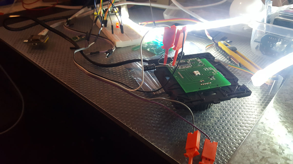

At this stage I’m trying to integrating a RWCL-0516 radar motion sensor into the Meek switch. I’m struggling to resolve the interference between the ESP8266 and the RWCL-0516 sensor.
In the new Beta’s, the antennas of the ESP8266 & RWCL-0516 are separated as “far as possible” on the PCB’s, also added some extra electronic components to eliminate fluctuations on the power lines.
If you have any thoughts on resolving the interference, please let me know.

Looks really cool Meek.
I dont know how to solve the interference but i dont think you need a motion sensor on each wall switch but in a few it could be very handy.

Good point, as I’m in the developmental phase, it’s nice to explore the possibilities, but your right, the development process should not be overtaken by a “gimmick”.
Nevertheless, I’ve assembled the Meek switch with an integrated RCWL-0516 module and with all the filters, the accuracy improved enormously. That been said/written, in the first night where I tested the Meek switch, he gave 3 “false positives” during a 9 hours trial.
I’ve setup the switch in my kitchen that overlooks at our garden. It could be possible that there were some animal activities that has been captured by the sensor but I cannot tell for sure. But no matter what caused the “false positives” the results was not satisfactory.
So I went back to do more testing and measuring and found that by repositioning the sensor (although it’s a 360degree sensor) the accuracy improved even more !

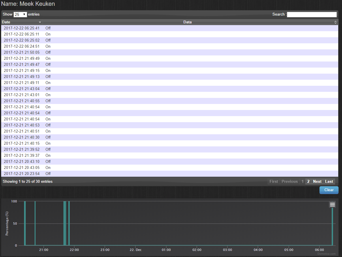

The last test over a period of 10 hours, had a hit rate of 100%.
Now I need to finalize the code/rules to operate on motion once the Lux meter drops to a certain level.

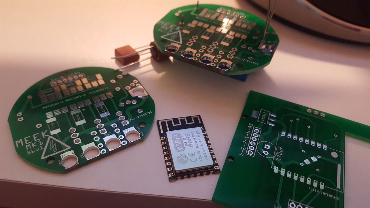

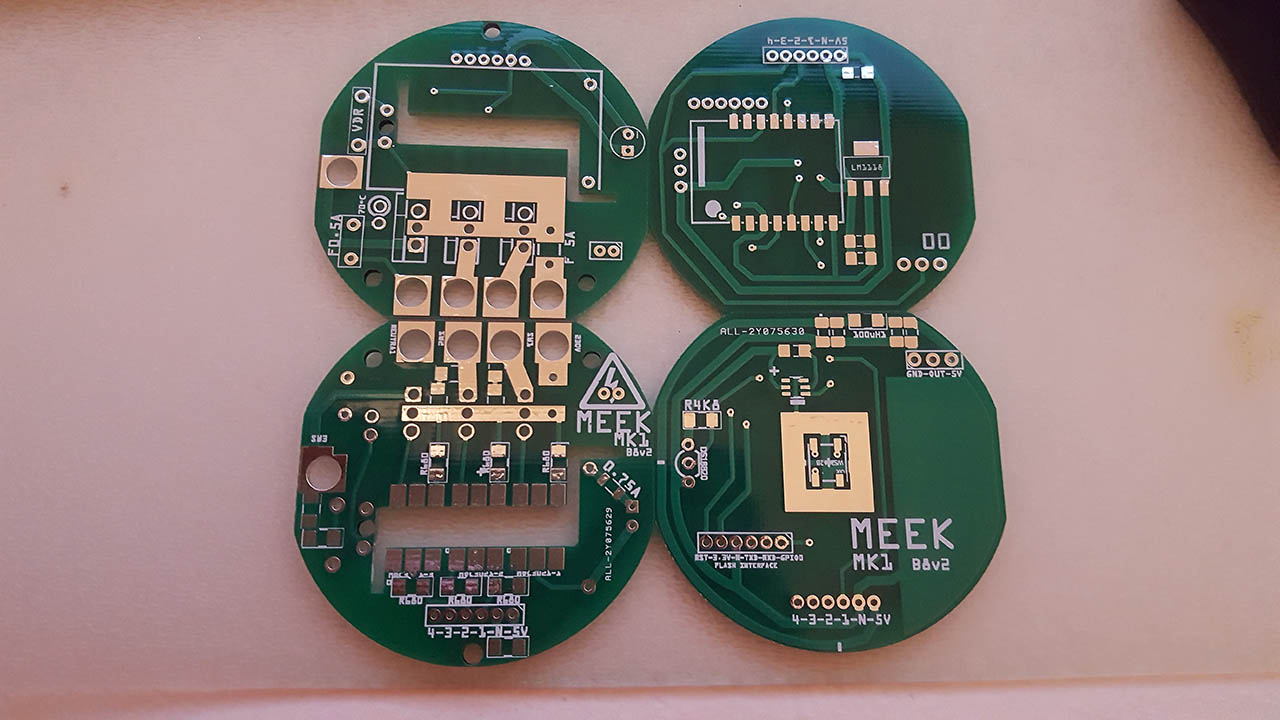

Herewith a picture of the PCB designs that will make it into the production models.
As the development of these Meek switches are nearing completion, I’m shifting my focus on the expansions.
One of the most requested expansion is, by far, the Meek dimmable Wifi Enabled Smart Switch.
