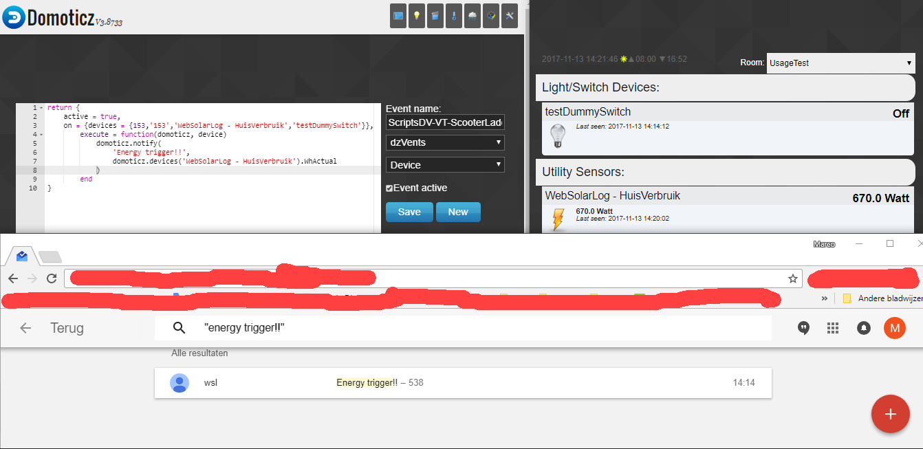

yep, 3.8733 and for what I can see it's not working.
Here an screenie with my dzvents "script"(no rocket science), dummy Switch, Dummy Electric Usage, email.
The Dummy Electric Usage is updated every 2 minutes, the dummy switch I trigger through Domoticz web/Android UI.
Screenshot - 13_11_2017 , 14_21_59.png (80.4 KiB) Viewed 810 times
As you can see the mail is received at the time the dummy switch is switched and after that the Dummy Electric Usage is updated, but no new email/notification is received.
Which pull request should fix this?
