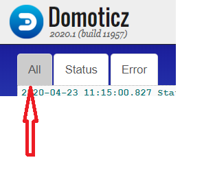

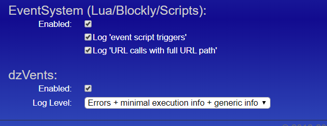

I've added the script in domoticz (from the web interface) and changed all the values to fit my configuration.
Is it normal that I don't see anything happening in the logs ? Dvents scripts are enabled in the settings and I've put log level of the script to DEBUG
Running domoticz 2020.01 (last stable)
Thank you
Re: Check Sensors script (dzVents)
pimseb wrote: Thursday 23 April 2020 10:58 Is it normal that I don't see anything happening in the logs ?
No,you should see something. Are you looking at ALL messages in the log?
Did you also enable the EventSystem ?
[setup] [settings] [other]
and applied the settings?(red button in the top right corner)
