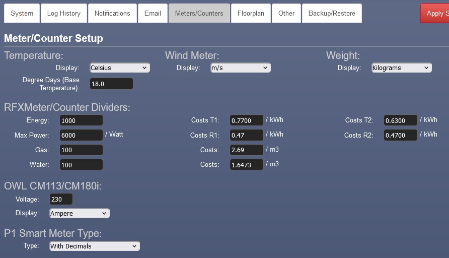

Another thing.
In your script you insert costs.
Isn't it possible to use the values added in Domoticz and how can these be extracted?
Meters Counters.jpg (65.64 KiB) Viewed 1398 times
