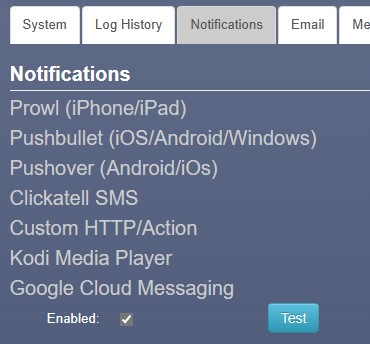

Remark:
Instead of Telgram one can use Google Cloud Messaging.
Google Cloud Messaging.jpg (28.96 KiB) Viewed 1343 times
Despite that it has been deprecated it still is alive for our purposes.
In your script:
-- Notificatie voor verschillende aanbieders
	    -- dz.notify(subject, message, dz.PRIORITY_MEDIUM, dz.SOUND_PERSISTENT, nil, dz.NSS_TELEGRAM)
            dz.notify(subject, message, dz.PRIORITY_NORMAL)

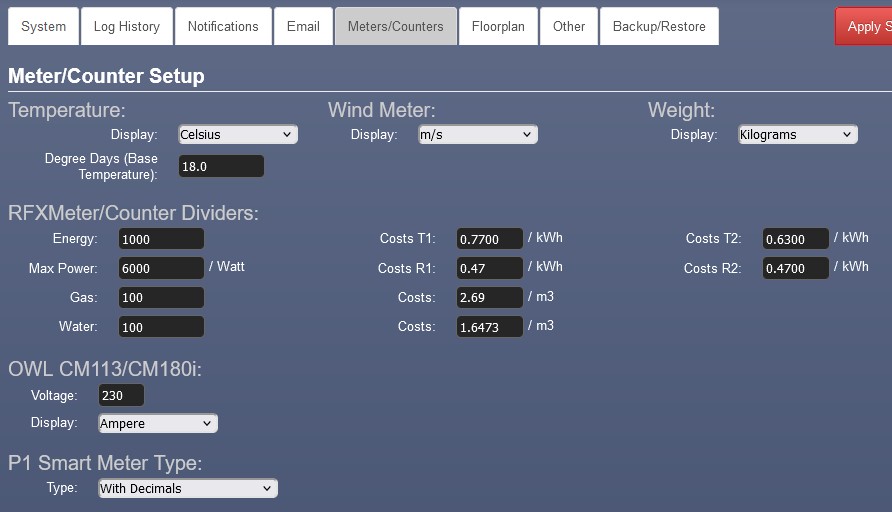

Another thing.
In your script you insert costs.
Isn't it possible to use the values added in Domoticz and how can these be extracted?
Meters Counters.jpg (65.64 KiB) Viewed 1339 times
Last remark:
What's the use of this script when one can retrieve dayly usaage and costs from your energy supplier in a nice app.
