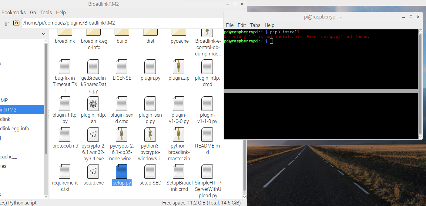

Gave it a shot but I get the following even though I see setup.py in the folder.
pi@raspberrypi:~ $ pip3 install .
Directory '.' is not installable. File 'setup.py' not found.
pi@raspberrypi:~ $
[img]
Screen Shot 2017-04-28 at 10.07.58 PM.png (396.22 KiB) Viewed 4664 times
[/img]

[img]Screen%20Shot%202017-04-28%20at%2010.07.58%20PM.png[/img]
strange as this work on my windows version.
do not have any linux, so not able to test but this is what i have seen on the web and that you can try :
pip install /full/path/of/your/broadlink/folder
Have seen your screenshot and just FYI: there is too much files on the plugins folder, see wiki.
You should put others files somewhere else, will be better.

Hi, I was having this exact problem too, so was very grateful for your advice! I downloaded the setup.py for 0.3 as you suggest - however, although Python tells me Broadlink is installed as a package, there's no broadlink folder under the python dist-packages folder so doing the
"sudo cp -r /usr/local/lib/python3.4/dist-packages/broadlink /usr/lib/python3.4/" fails.
Any idea why I'm not getting that folder created? Obviously my system isn't working... :cry: Thanks in advance. Jeremy.

@DrJS
hi, maybe you have mixed python version i.e; 2.7.x & 3.x ?? !!
if this is the case, pip command would install on the default one, which is probable 2.7.
you need to use pip3 if i'm not wrong, but first I would uninstall broadlink from 2.7 (pip uninstall broadlink)
