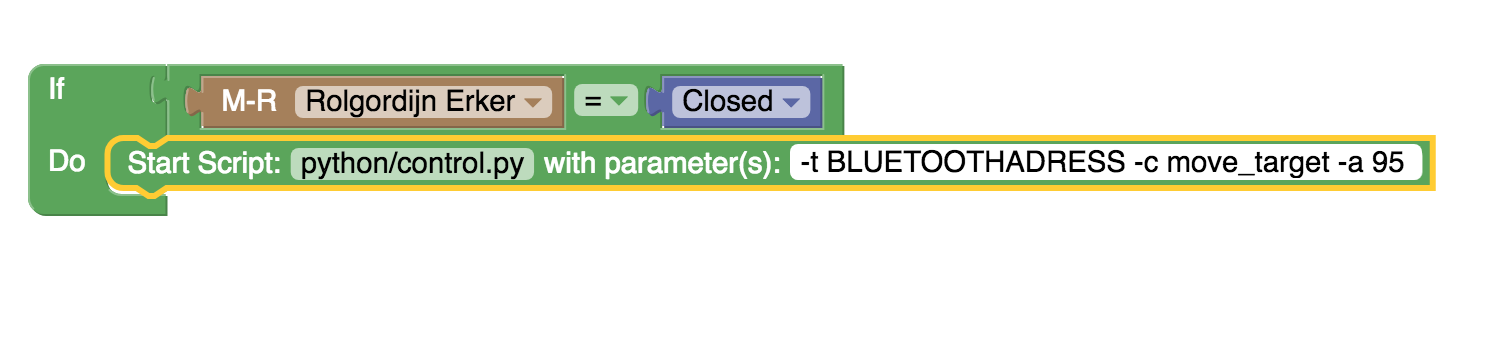

Thanks for your update! I just couldn't get the sh script working, giving me a 512 error. This same error code suggests lua won't work either. So before I started with your solution I tried the blockly events, and that worked!
Thinking in this direction, it should also be possible with % slider in stead of open/closed.
See image attached...

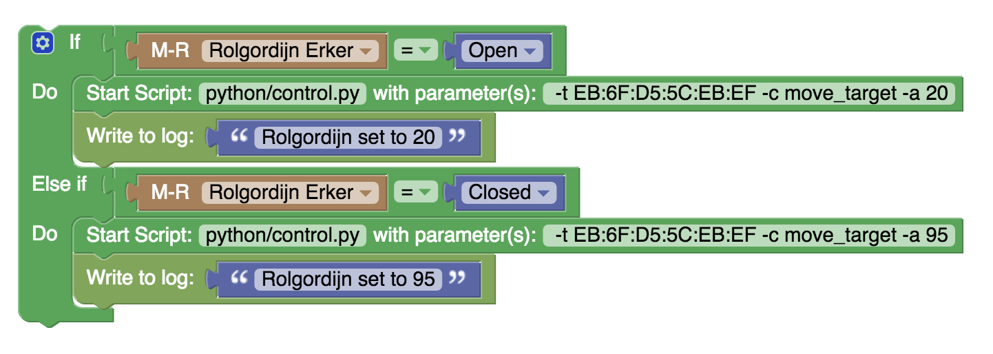

Here a integrated closed and open blockly. (WORKING

I guess for the slider it would be something similar...

I also thought so. I created a nice test percentage blind switch, the value of the blind percentage dummy switch contains open/close value, not the percentage. The percentage is in the Svalue and the sad news is: "Reading sValues (temperatures etc) does not work either." According to the wiki: https://www.domoticz.com/wiki/Events
Sorry if this is correct... (because I'm note sure, maybe there is another way/workaround).

Not sure about blocky, I know from LUA I could access the svalues. Probably it has to do with not being able to do maths with it...
