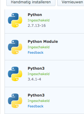

DennisD wrote:Python 3.x is installed?
I thought I had. But now it says 2.7.12
But on the Synology paackage screen I get this
Python versions installed
Screen Shot 2017-05-14 at 17.45.20.png (41.87 KiB) Viewed 5927 times
Re: Python Plugin: Samsung TV
Posted: Sunday 14 May 2017 17:55
by DennisD
Not sure then on the Synology, i'm working with a raspberry pi 3 so slightly different
