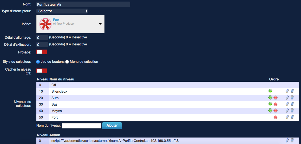

I'm having some problems :
This works :
/var/domoticz/scripts/external/xiaomiAirPurifierControl.sh 192.168.0.55 off
sudo /var/domoticz/scripts/external/xiaomiAirPurifierControl.sh 192.168.0.55 off
This does not work :
Pushing the button on Domoticz
I don't have any errors thrown in the log.
Capture d’écran 2017-10-22 à 20.13.53.png (98.92 KiB) Viewed 5667 times
Capture d’écran 2017-10-22 à 20.13.28.png (14.76 KiB) Viewed 5667 times
Any ideas ?
Thanks for your help :)

New problem for me :
Domoticz:/var/domoticz/scripts/external/xiaomiAirPurifier.js 192.168.0.55 power off
Sending Power off command
(node:21561) UnhandledPromiseRejectionWarning: Unhandled promise rejection (rejection id: 1): SyntaxError: Unexpected token o in JSON at position 0
No idea what to do with this.
Any advise ?
Domoticz Beta on Rasbperry Pi 3
RFLink / YeeLight / Xiaomi Devices / 433MHz / SonOff via MQTT
tho071088
Posts: 18
Joined: Monday 24 April 2017 23:03
Domoticz version: Stable
Location: Gerstheim, France
Re: Xiaomi Air Purifier 2
Post by tho071088 »
All solved
tho071088 wrote: Tuesday 24 October 2017 22:45 New problem for me :
Any advise ?
This one was my fault, wrong command sent.
For the other one, I had to make the require this way :
Not working :
const miio = require('miio');
Working :
const miio = require('../../../../usr/lib/node_modules/miio');

any idea?
Custom Sensor type worked for me
Works! thanks!
