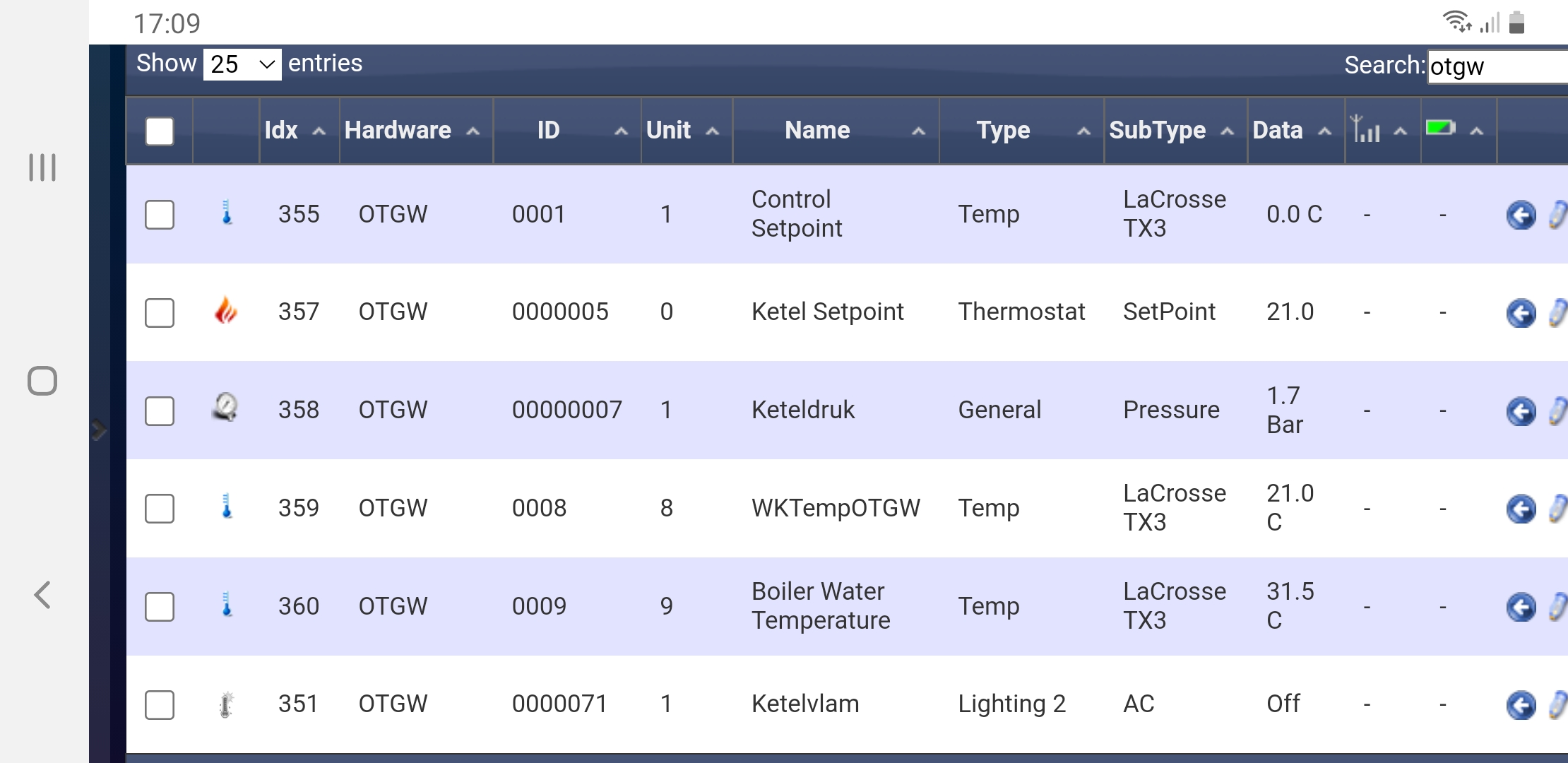

By 'sniffing' my thermostat wire, I'm able to read many values in Domoticz (see screenshot) but unable to control my Remeha unfortunately.
