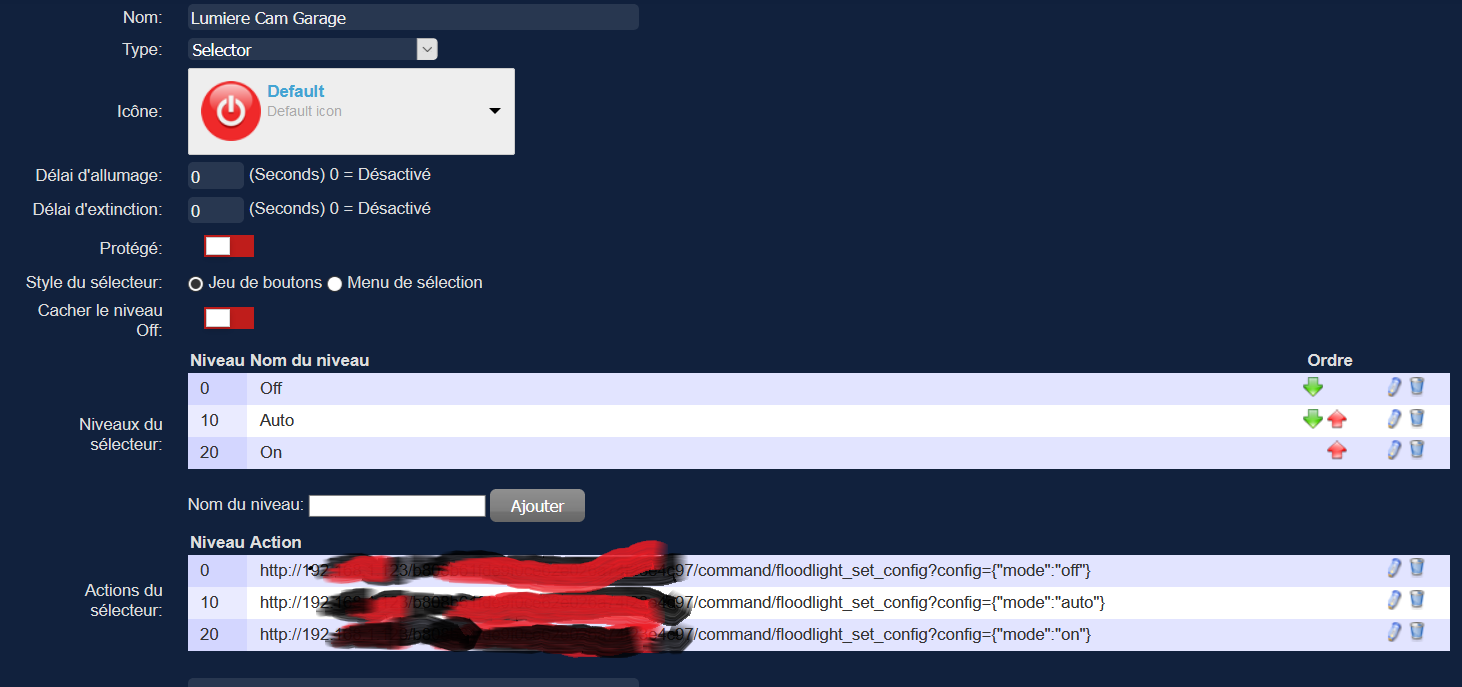

salopette wrote: Sunday 22 December 2019 13:53 is it possible to switch the light from the spot on and off via a switch in Domoticz?
yep, this is how I manage that :
Screenshot_2019-12-22 Domoticz.png (140.4 KiB) Viewed 2089 times
you need to find the camera local ip address and device Id or similar...
do some research on the forum to found how.

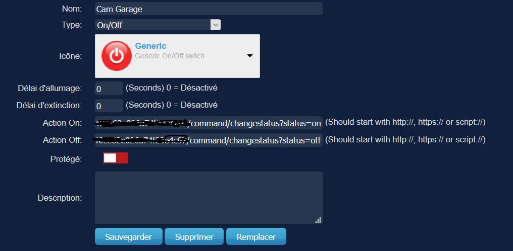

salopette
Posts: 187
Joined: Tuesday 07 March 2017 21:03
Location: Germany
Re: Netatmo Welcome Camera Guide
Post by salopette »
Wow thank you very much!
And you also integrated the video in Domotcz? Do you have instructions from the first post?
zak45
Posts: 954
Domoticz version: V2024.4
Post by zak45 »
salopette wrote: Sunday 22 December 2019 17:58
this is for the video, once you have retreived your information :
Screenshot_2019-12-22 Domoticz.png (28.35 KiB) Viewed 2081 times
salopette
Posts: 187
Location: Germany
Post by salopette »
Thank you very much, set everything up and worked!

On the same, this is the dummy switch for monitoring on/off.
Screenshot_2019-12-26 Domoticz.png (44.26 KiB) Viewed 2044 times
