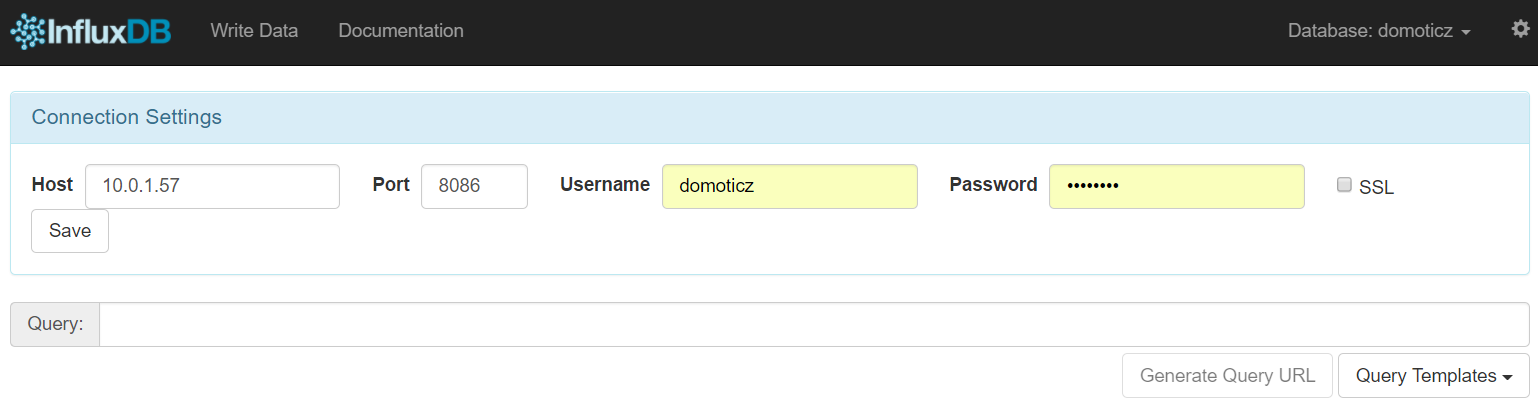

Go to: http://[IP]:8083/
CREATE DATABASE "domoticz"
Setup the user (domoticz/domoticz) in InfluxDB Connection Settings:

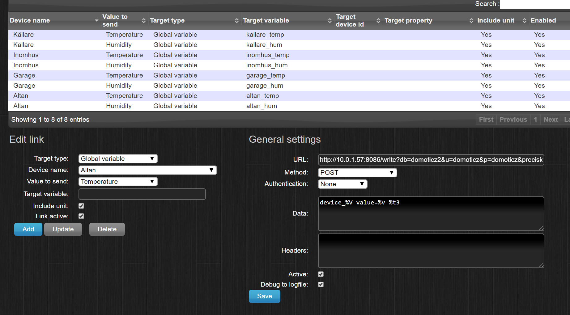

In Domoticz go to: Setup => Settings => Data Push => HTTP Link
Use the following URL:
http:// [IP]:8086/write?db=domoticz&u=domoticz&p=domoticz&precision=ms
Setup the sensors like in this screenshot (device_+"Target Variable" will be the table name in InfluxDB:
Verify that there's data in the relevant InfluxDB table, e.g. SELECT * FROM deviceX

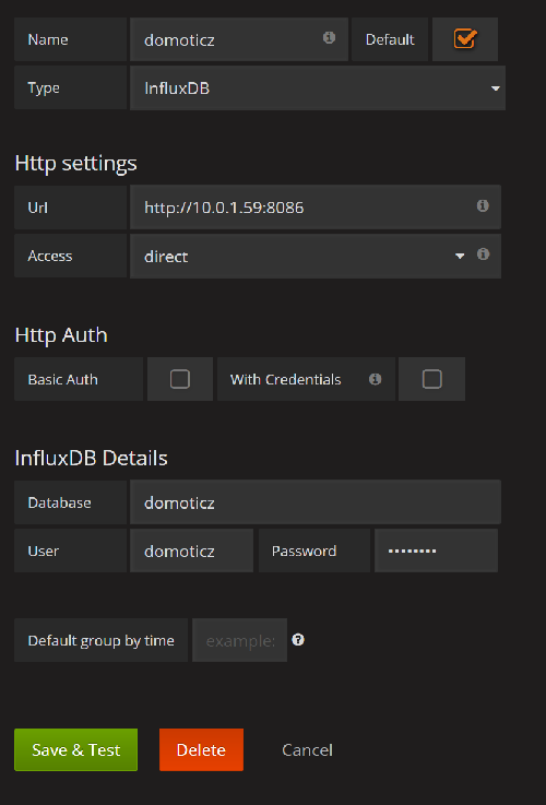

Add datasource
Create a Dashboard.
Done!
