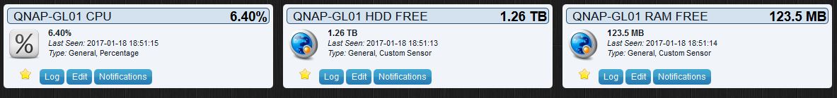

And the degree symbol. Depends on the sensor used for Free Space. I created a Custom Sensor, because values go Up/Down, not all sensors accept that. Eg the temp-sensors can but most counters can't.

Just Click create sensor at Dummy Hardware. Choose Custom Sensor. And fill in the blanks... done that a few weeks ago, and currently not near my domoticz server.

i think the ° sensor in not real, i try to use a % sensor. i change the idx in the script and i think work ok. this is the screenshot. the value read in smnp is already the free spase on the disk ?? or another value ???? i don't understend this.

guantolento wrote:i think the ° sensor in not real, i try to use a % sensor. i change the idx in the script and i think work ok. this is the screenshot. the value read in smnp is already the free spase on the disk ?? or another value ???? i don't understend this.
The free space which is monitored by SNMP is the real free space in MBytes. In my case 1 RAID Volume 0,92 TB.
The others are Temp (5 in my case, 1 cpu and 4 disks)
As i recall theres no calculation of the difference and percentage.

now i take another 2 value. ram free and hdd free.
Master (pi3) - MB sensors + Dummy + Sysfs gpio + 1 NodOn MSP-3 + 1 Aeotec DSB28 Energy Meter + 3 Danfoss RS Room + 7 Danfoss Z Thermostat + 1 Swiid Inter + 9 FGS222
Slave01 (pi2) - MB sensors + Dummy + Weather Underground + 2 FGS223 + 1 FGWPE/F
Vulpecula
Joined: Wednesday 18 October 2017 14:25
Domoticz version: V3.8153
Re: HowTo: monitor QNAP NAS
Post by Vulpecula »
Can you tell me how you got the decimal part correct? My Nas has 2,6 TB free space but domoticz sees it as 3 TB
[Edit]
Found it, need to use a "Custom sensor"
