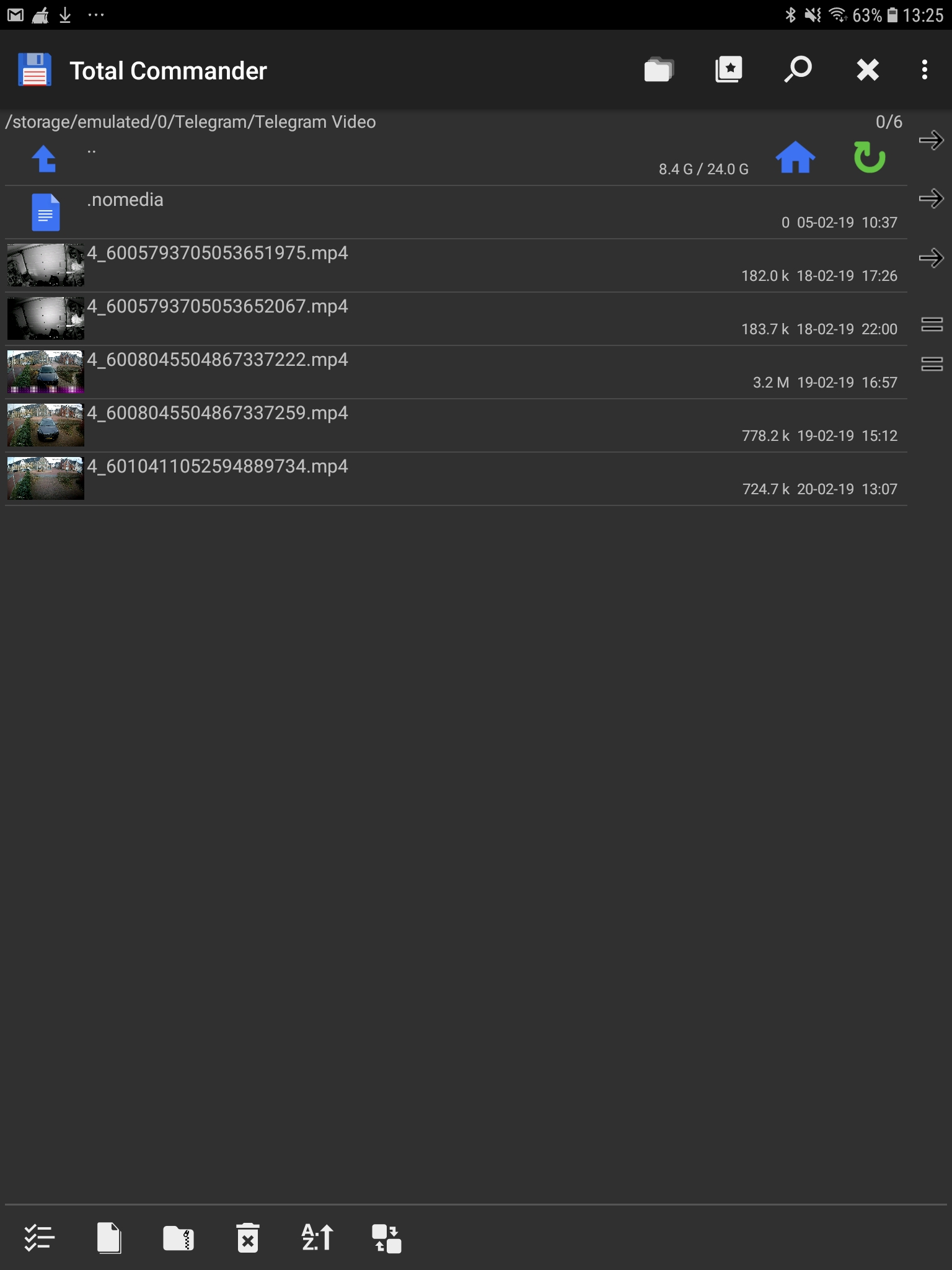

Nope
Screenshot_20190221-132506_Total Commander.jpg (244.86 KiB) Viewed 2475 times
