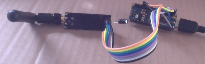

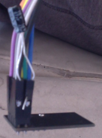

This can work, but it get loose a lot...
Photo on 01-08-16 at 18.56.jpg (38.07 KiB) Viewed 4336 times
Photo on 01-08-16 at 17.56.jpg (41.68 KiB) Viewed 4336 times

This is the output you get when the radio is not working.
Look at the output of a sensor with a loose capacitor. You can see where I pressed it ;-) And the point I really pushed to get a connection. I would solder it ;-)

It seems that the capacitor is too small in my case.

Looks like you have PA+LNA radio - it does require an external power (not from Arduino Nano in your case). Either try to use a normal radio or provide a separate stable 3.3V power to the radio.
The above error message means that the node cannot connect to the GW.
