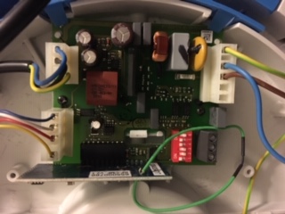

stijnb
Joined: Wednesday 14 February 2018 13:08
Re: Sonoff/ESP8266 (Duco/Storkair etc) mechanical home ventilation control
Post by stijnb »
bbqkees wrote: Tuesday 27 March 2018 9:43
stijnb wrote: Friday 23 March 2018 12:58
bbqkees wrote: Wednesday 14 February 2018 16:53 Looks like not L3 but L1 is the high mode of your unit, but i can't really see it in your image.
Would it help if I made some additional pictures?
One picture with aclear view of the schematic on that junction box will do.
So this is the schematic
bbqkees
Posts: 407
Domoticz version: 4.1x
Post by bbqkees »
So that took you a while.
You need to have L3 connected to L (brown) at all times.
Additionally switch L1 with L (brown) via the Sonoff.

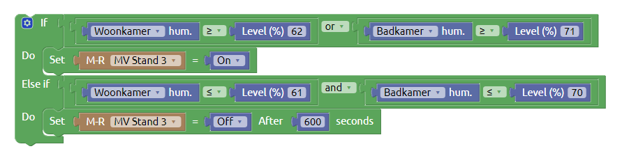

Thanks to this post i have made my Duco Silent automated within Domoticz. Thanks for that.
i am using Blockly because that is for me easier because i can not program in lUA.
I have below Blockly now:
It is working fine except for the livingroom. There the raise in humidity is smaller so it is not working.
Does anyone know if it is possible to work with Blockly and then say that when there is a raise of 2% within X time that it will start ventilating?

paulie72 wrote: Thursday 16 January 2020 13:16 Thanks to this post i have made my Duco Silent automated within Domoticz. Thanks for that.
I was actually wondering the same thing...
Thinking out loud;
- store a number to a dummy (?) and compare it period x later?
OS: RPi4B, GH
