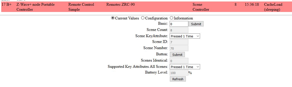

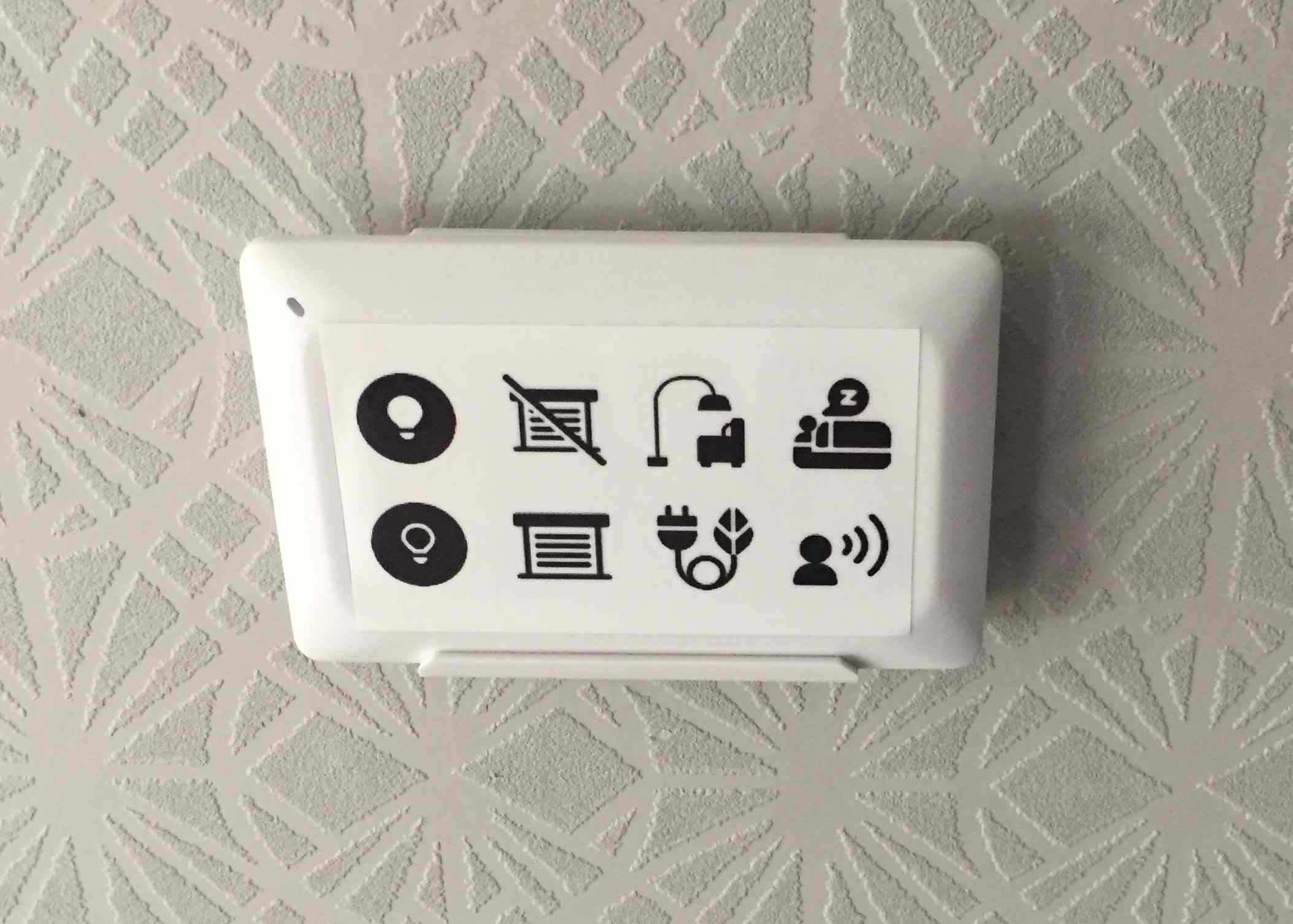

I recently installed the ZRC-90 and can confirm what you see. For now nothing more than 8 'switches' that only send 'on'
The extra functionality is in there, you can see that in the zwave panel. Think it is not supported yet.
Anyhow for now , happy with the switch functionality , placed a sticker over the buttons to use icons instead of numbers..

SystemLord wrote: Thursday 05 October 2017 17:13 Anyhow for now , happy with the switch functionality , placed a sticker over the buttons to use icons instead of numbers..
Really nice sticker, did you just print that on label paper?
Nope, it is a professional sticker. http://plakfoto.nl/index.php?option=info
Here you can upload your design, choose formats and order a single sheet instead of pile of stickers.
