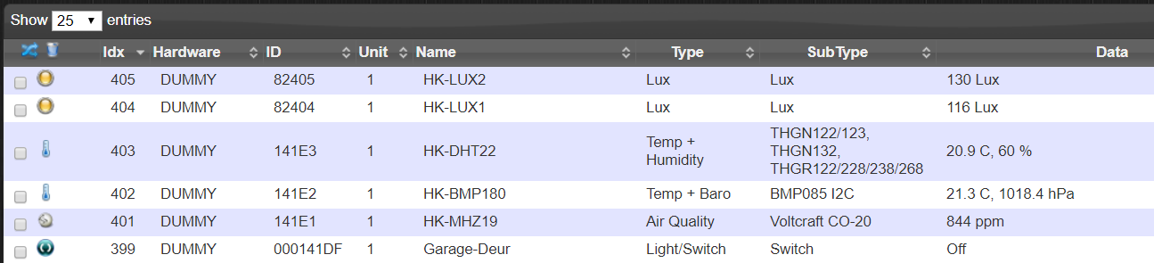

I am running an Wemos D1 + MH-Z19b since a few months now with a modified version of ESPEASY I made as described here: https://gathering.tweakers.net/forum/li ... 9#52624079
This Wemos also has 2 LUX sensors, a DHT22 Sensor for Temp&Humidity and a BMP180 Barometer (Presure).
All these devices are directly updated via the build in options of this modified ESPEASY version by a URL call.
The devices are all setup in Dummy hardware which you first need to create yourself and then use the IDX in the ESPEASY definition for the device:

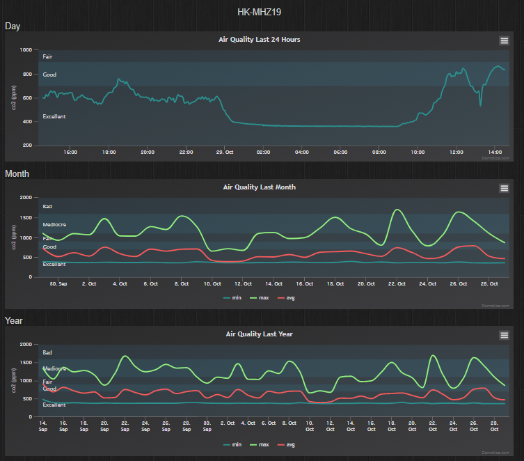

The graph created by the MH-Z19b/CO-20 looks like this:
The thread I linked is a good place to find some information about the usage of this setup.

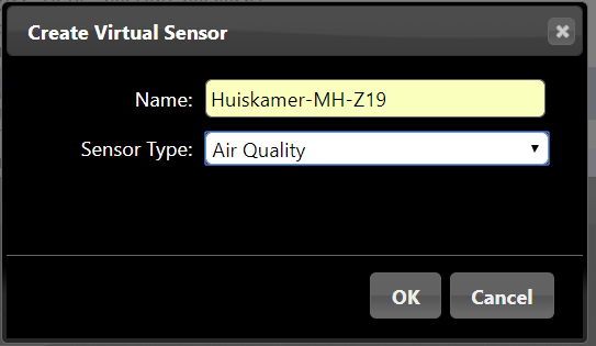

Add Airquality device to Domoticz:

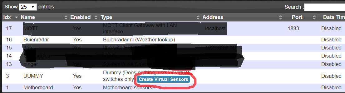

Goto the Domoticz webpage and select: Setup/Hardware.
Add A dummy Sensor:
Make a note of the created device IDX found in in Setup/Devices

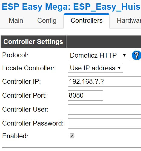

Define the Domoticz server under the controllers Tab:
and fill in the appropriate information to connect to your Domoticz server.

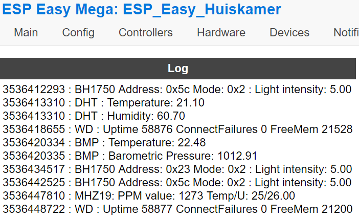

Under the Tools/LOG option in ESPEASY you find information about the steps ESPEASY does and when it receives information.
This is the log I have and you see also the MHZ19 in there:
Shoot when you have questions.
Jos
