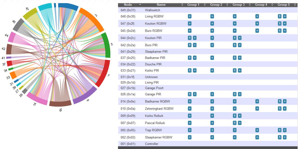

I also experience this behavior. Last night I turned on the lights in the bathroom to discover that all the other lights were also turning on (bedrooms of my childeren, so they woke up
When going to the zwave setup I see that 4 nodes are just like that in group 1 attached to the "broadcast" 255.
I cannot remove them from that group neither.
Something weird and funny is going on.
This only occurs after a reboot by the way!

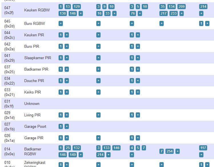

Today AGAIN one of my RGBW dimmers suddenly showed a lot of connections to other devices in the "groups a natwork" table ...
There was no Domoticz reboot, no software upgrade ... nothing changed to the system ... just like this ... out of the blue !
it's also remarkable that this ONLY happens to RGBW dimmers ... never to PIR sensors or other Zwave devices ...
... every few weeks these "ghost-connections" suddenly appear on one or more of my Zwave Fibaro RGBW dimmers
This is very annoying because it means that this Zwave network is NOT stable at all ...

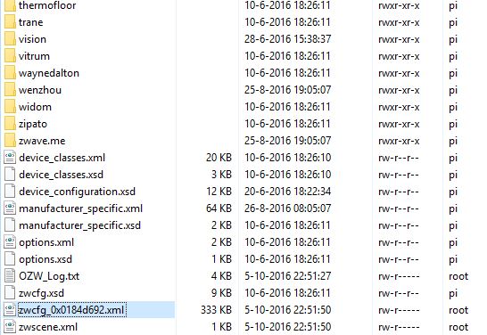

> Check if the zwcfg.xxx.xml is from the user and not from root.[ config map ]Derik wrote:Read this part...
http://www.domoticz.com/forum/viewtopic ... cfg#p83308
Step by step!!!
Login with Winscp...
Otherwise remove this file.
And reboot the pi or your hardware.
Check the zwcfg... not ROOT!!
And then wait a few hours...
it said : Owner : Root
so I deleted it
after rebooting, again the file re-appears : zwcfg_0x0184d692.xml - owner : Root
it shouldn't be owner : root ?
But it is ! WTF !!
After a few minutes it had rebuilt the Zwave network and now it looks "clean" ... but for how long ???
fingers crossed !
RasPi2 - Aeotec Z-Stick S2 - Fibaro multisensors - Fibaro RGBW dimmers - ETH08 relais boards
