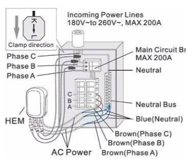

We use a "simple" HEM 1 with 1 fase.
But I think you are right.
See picture below from the manual.
- Screen Shot 2019-05-12 at 16.32.54.png (140.37 KiB) Viewed 3290 times
Nautilus
- Posts: 722
- Joined: Friday 02 October 2015 12:12
- Location: Finland
Re: Aeotec Home Energy Meter Gen 5
Thanks - saw the same on online documentation, but wanted to make sure that I've really understood it correctly. Too bad, makes the purchase much less intriguing for a non-electrician (it's 75€+ for even a 5 minute visit of an electrician). Does anyone know any similar devices with 3-phase measurement and a possibility to detect the direction (import/export)?
