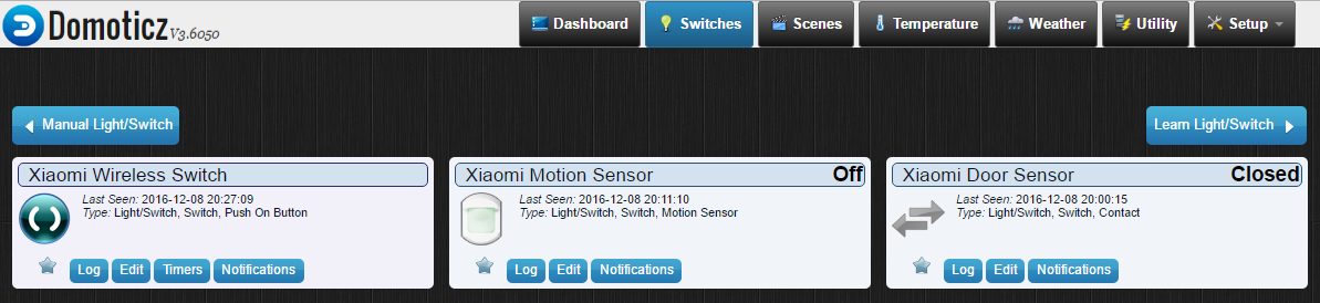

ok thanks, will make it a 'push on' button, and have it stay on for a couple of seconds for single click, 10 seconds for long click, and something else for double click

Wireless switch and door sensors have been added:
- door_sensor.PNG (79.92 KiB) Viewed 7946 times

Yes ! That is good !corbin wrote:Wireless switch and door sensors have been added:
