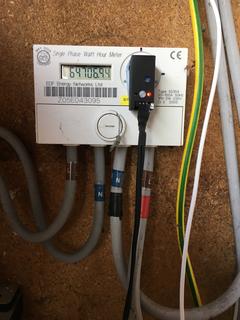

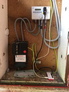

I have been using this script successfully for electricity only. I am using the photosensor as described in the OP, together with a dedicated RPi Zero W, sending readings via WiFi to Domoticz. Here's how it looks in my meter cupboard:

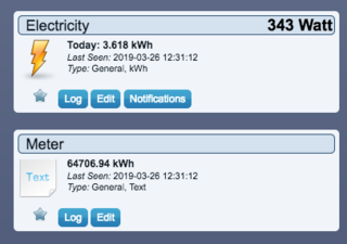

I've also amended the script, to show the meter reading, which - over the last 48 hours - has been spot on with the actual meter (never missed a pulse)!

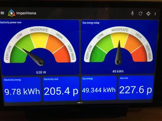

I've also created a 'smart meter' dashboard, using ImperiHome (via MyDomoAtHome) on an Android tablet:

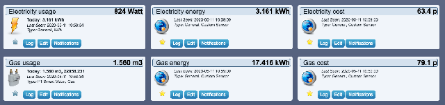

I've extended this further, with a dzVents script to display energy and costs, using custom Domoticz sensors:

Here, you'll need to substitute your own energy unit costs.
This gives me the following in my Utilities tab in Domoticz:
Finally, the 'smart meter' display in my previous post was created in ImperiHome on an Android tablet - you'll need MyDomoAtHome for this (see the Domoticz wiki for this).
