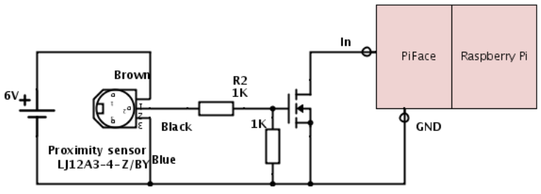

Please note: I changed the schematic. Somehow i managed to destroy the Mosfet and had no replacement available. So i changed it to a reed relay which switches the PiFace input. Maybe a less complex solution also... Now see if the watermeter and Domoticz will stay in sync.
EDIT: Over the past 2 days and 258 liters of water consumption the analog meter and pulse counter are perfectly in sync.

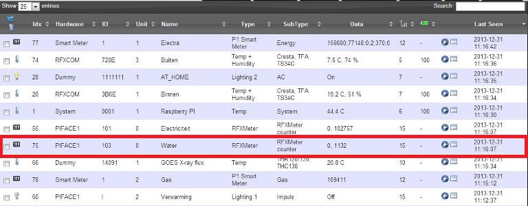

Do you see the input in your device list? Like this: Did you restart Domoticz after changing the piface.conf? What does the log show you?
You can test the input and counter by pushing the button 4 a couple of times. This should show up a number of counts after a minute (in the picture you can see i used 1132 liter since the start).
For the config: The input is disabled as a plain input (Lighting 1 type) but only enabled as a counter (RFXmeter type).

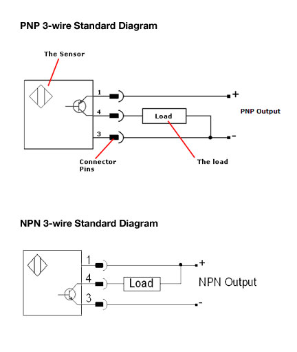

If its really the LJ12A3-4-Z/BY you have it has a PNP output. This means the black wire will be switched to + (brown) when active. So the load is put between black and blue.
The LJ12A3-4-Z/BX is of the NPN type. In your case the diagram with the FET should then be changed a bit.
A S0 output could, if powerfull enough to drive the reed relay coil, be used with a reed relay. They are fast and last long. But i'll try to see if a transistor can switch the PiFace input. If so, an opto coupler would be the better way...

Just looked at it, but i cannot find a way to connect it using the bs170 fet i have
Would you please be able to make a little drawing on how you meant it ?

You could try it like this: The idea is that if there is no metal detected the voltage on the gate is 0V therefore no current through the FET and thus a 3.3V at the input (through its internal 330 ohm pull-up resistor) = not active. When metal is detected the black wire will carry 6V which is divided by the two resistors to 3V at the gate. Enough to put the FET in conducting state and pulling the input to ground = active. If you decide to use 12V supply R2 should be increased to 3K3.
Hope that helps.

Although i noticed something " strange" on testing
When testing i was holding the sensor to a piece of metal and checked if domoticz would give the correct numbers, then i made a list of these numbers:
Sensor against metal Domoticz count
10 5
15 16
30 56
17 73
From there on Domoticz counts correctly.
You can see that Domoticz has a kind of a "lag", the first 2 counts of incorrect, only after the third count Domoticz catches up.
HAPPY NEW YEAR !!!
Alex
10 5
15 16
30 56
17 73
HAPPY NEW YEAR !!!
Alex

I'm not sure if i understand the table, but could it have something to do with the count_update_interval_sec setting in piface.conf for this counter?
If set to 60 the piface count value will be updated to Domoticz only once a minute, but counts will not be lost. You can see updates in the log like my watermeter:
Wed Jan 1 12:27:34 2014 (PIFACE1) RFXMeter (Water)
EDIT: Now i see.. one is the incremental as seen in Domoticz.. (sorry-still a bit early
). I'm still checking my real meter against Domoticz. The sensor has somehow counted 2 liters more on a total of 800 liters... not that bad!
/paul
/paul
